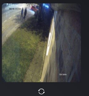

I gave it a few goes. I managed to get it to work briefly a few times but then for some reason it stops working.
For some reason the manual snapshot also seems to not load occasionally when I try to refresh it, , I’ve also tried doing the repair option that also seems to randomly time out.
I’m not quite sure but I have a feeling the ONVIF app is losing network connection with the camera . It’s almost as if they are losing communication somehow … ?.

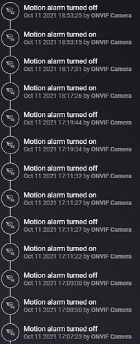

When I first add the camera in the OnVif App everything seems to work fine. It responds to manual snap shots quick. It responds quickly to line cross motion events. After a while though the motion events don’t respond as quick and start to get a bit patchy. After a period of time eventually all motion events stop responding.
Doing a repair doesn’t seem to fix it. After awhile the repair feature actually stops working and it starts to time out and snap shots also stop working. It’s as if the app loses communication with the camera.
If i delete the camera from the OnVif app and re-register it again it works perfectly for awhile , but then eventually degrades again.

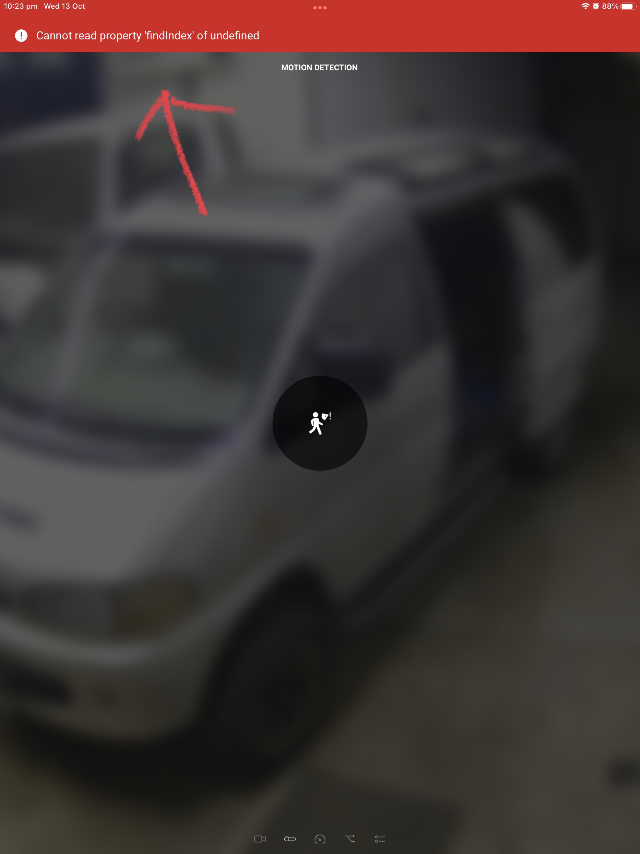

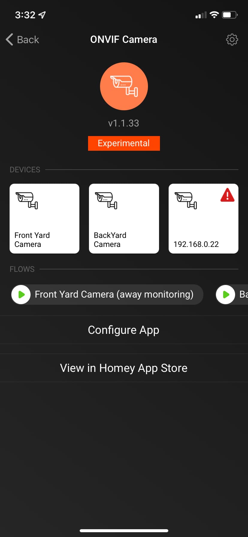

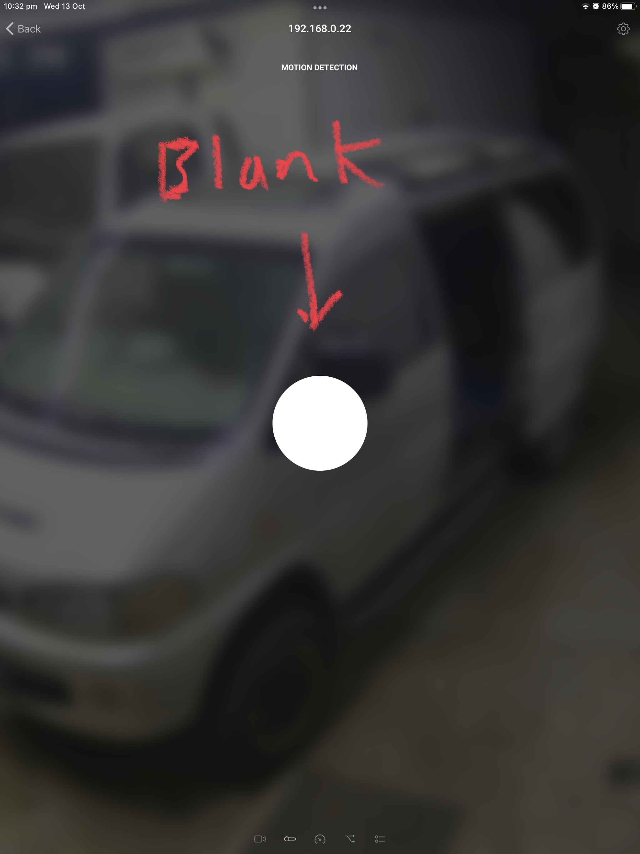

One thing that seems to always occur is whenever I set the settings to Analytic Service, save and exit , none of the new abilities show up in live Alarm monitor screen. I have to restart the ONVIF app for the new abilities to show up…
One thing I tried tonight (as an experiment) was set it up as a new device , set to Analytic Service , save and exit , but then reboot Homey rather than restart the App…
The new abilities show , but I can’t set the motion detection button to be on or off… It’s just blank. If I click on it I get an error.
Not sure if this is of any help or gives any further insight …
