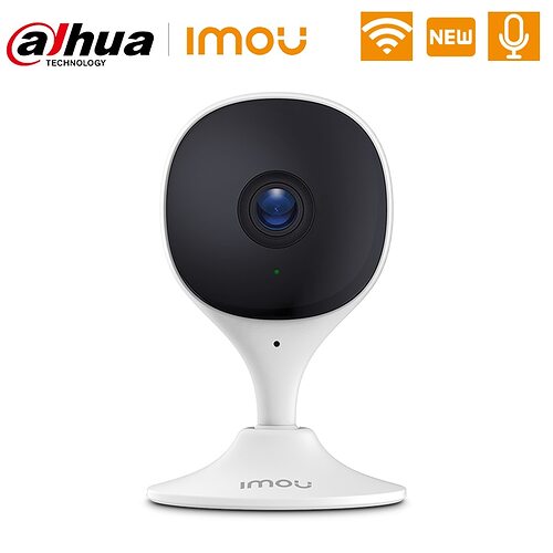

I ordered a couple of these cheap Imou Cue 2C mini wifi cams. They are supposed to be Onvif compatible, so I hope they will work on Homey. And they supposedly even work with Google Nest Hub! :slight_smile:
With Google nest hub they will work.
With this app i don’t believe they will, i have the imou cue 2 and although they say are Onvif compatible, they do not support snapshot feature or even alarm state, but these one’s you ordered are a new version of the ones I have, these are the cue2c so there is a chance that I’m wrong.
If i am, let me know please once you test them.
OK, that would be a pity. The 2C is even more basic than the Cue 2, so I doubt it will support more functions. I have not looked into it, but may be able to add it to Synology Surveillance Station on my NAS and get integration with the app that way?
I will report back when I get them (sent from ES so should be faster than CN).
About that I can not tell you about I’ve never used synology my self.
I like the TP-Link C100 more, but they dont support ONVIF snapshot. but is an better camera than Imou cue 2 for the money.
