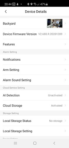

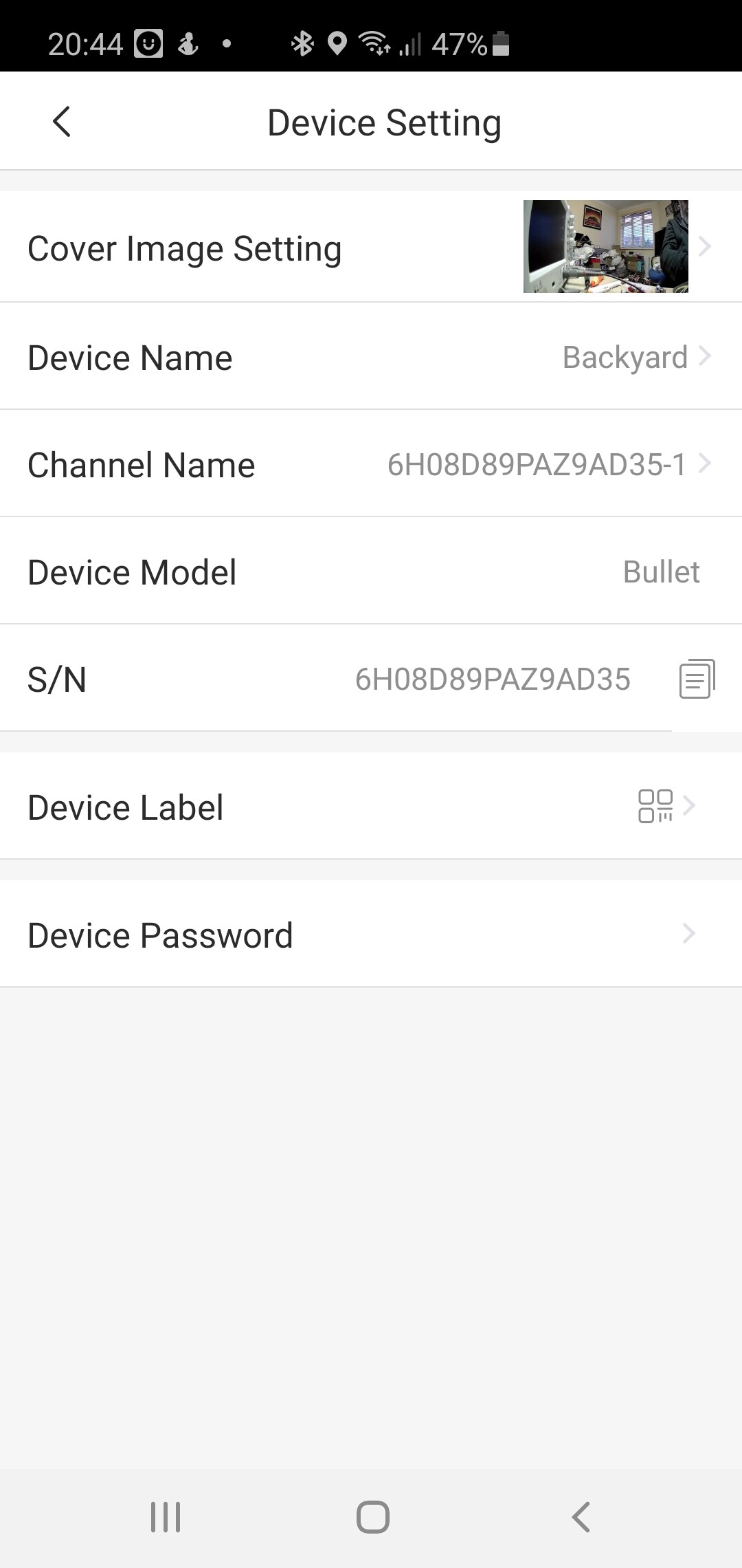

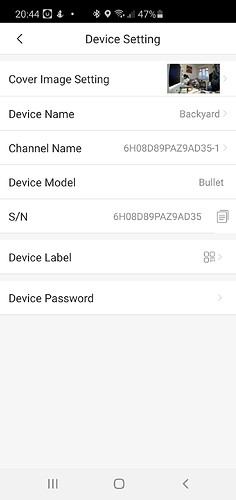

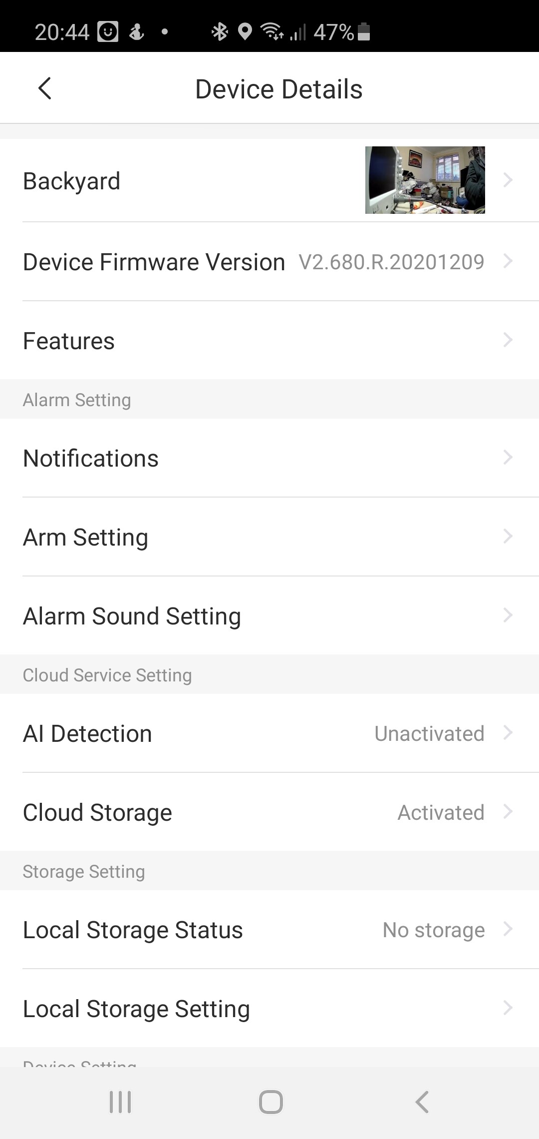

You set the device password in the app from Device Settings
Tap on the top picture
Then Device password.
The default is the safety code on the label attached to the camera.
The username is admin.

The username is admin and the password is the safety code on the Device Label in the menu above Device Password.
My email address and the password I created the online account with are not used for ONVIF.
