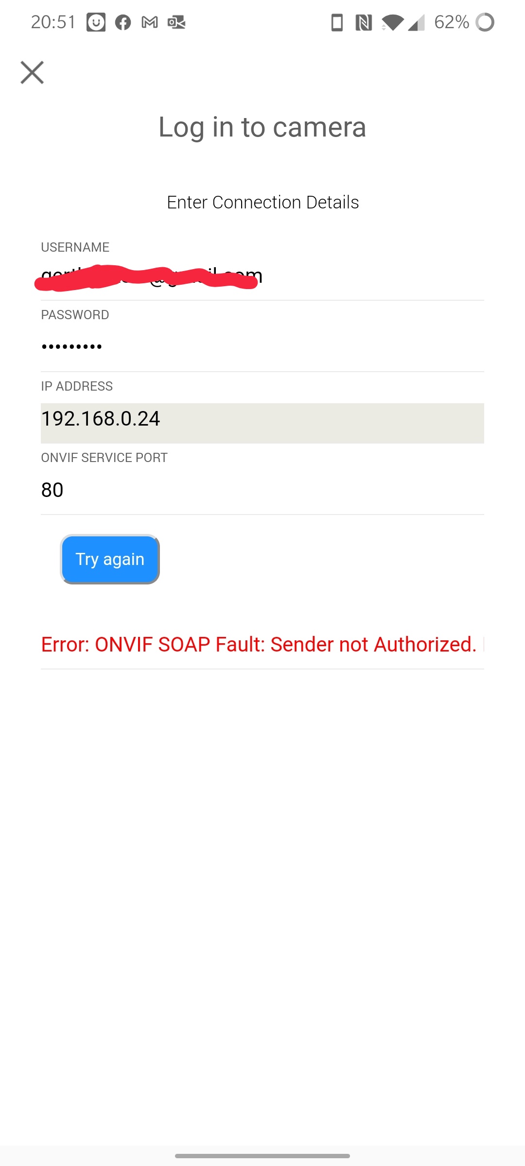

Who can help me with this setting?
Thank you!
The ONVIF account is usually different to any app account. Normally admin as the user. The default password might be on a label on the camera. Alternatively, you might need to create an ONVIF account via the camera app.
