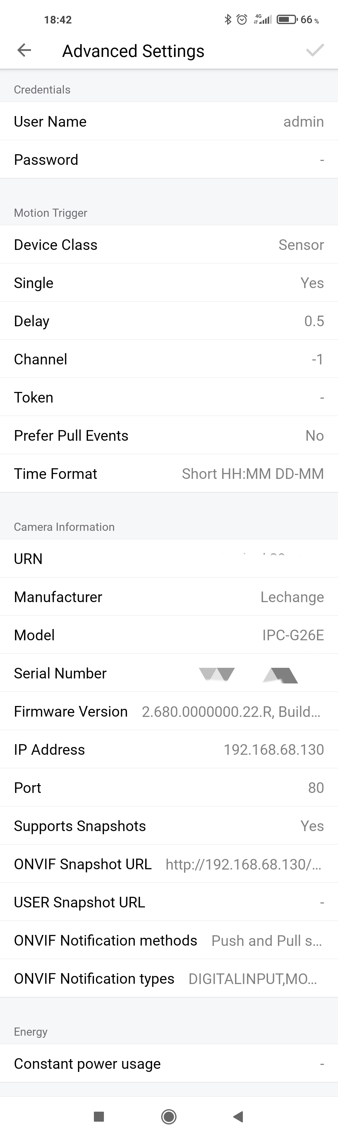

These are my Homey camera settings:
I can see a snapshot but the push messages about a movement are not received or understood by the Homey app.

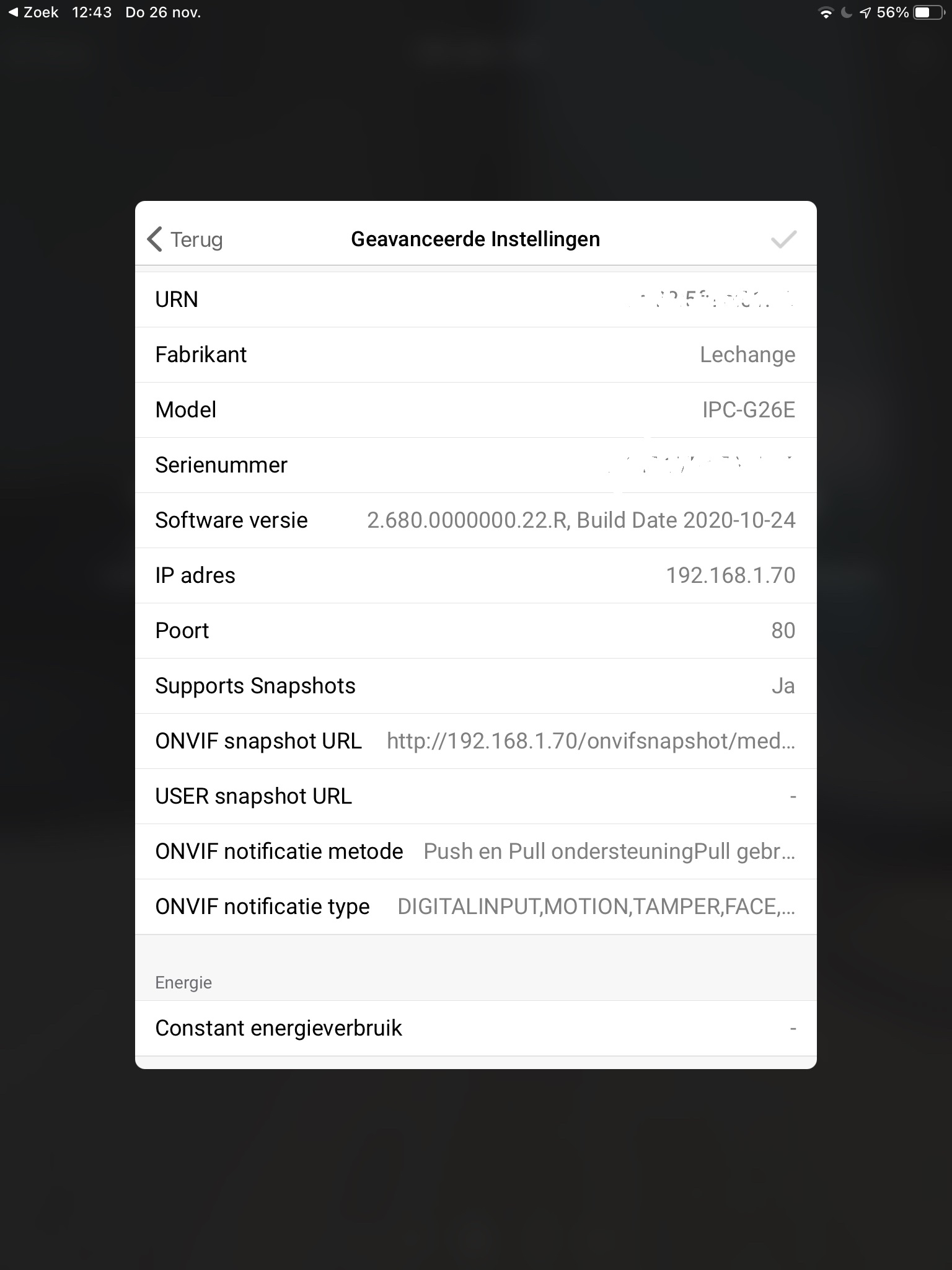

The firmware check gives a respons that the latest is on the camera.
Here is the log copy, but Im not sure if this is what you need.
Log ID: 2020-11-25T16:57:53.045Z
App version 1.1.18

Here it is, from ipc-g26e
But like i said, I’ve not done anything special with them, i just chose the camera i want to add, enter user and password, and connect.
That’s it.
The Imou Bullet Lite has the same problems. Everything seems to work but motion detection does not trigger and is instantly deactivated when setting up the camera.
Although it does work with the dauha app. But the app uses a different card it says when VideoMotionStart. But that does the same thing as motion detection.

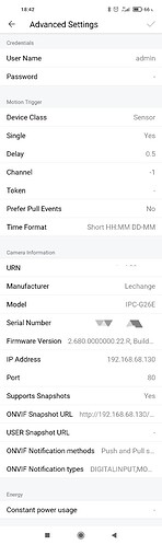

Thank you Adrian just sent it to you :slight_smile:
Hopefully it’s usefull :pray:t2:

the option to turn on motion detection is here, but it does nothing.
Can you look in the Advanced options and try changing to prefer Pull events to see if that helps.
Also send me the logs with both options so I can see what it’s doing.
Sent you a full log Adrian. Changing to prefer pills did nothing for me unfortunately.
