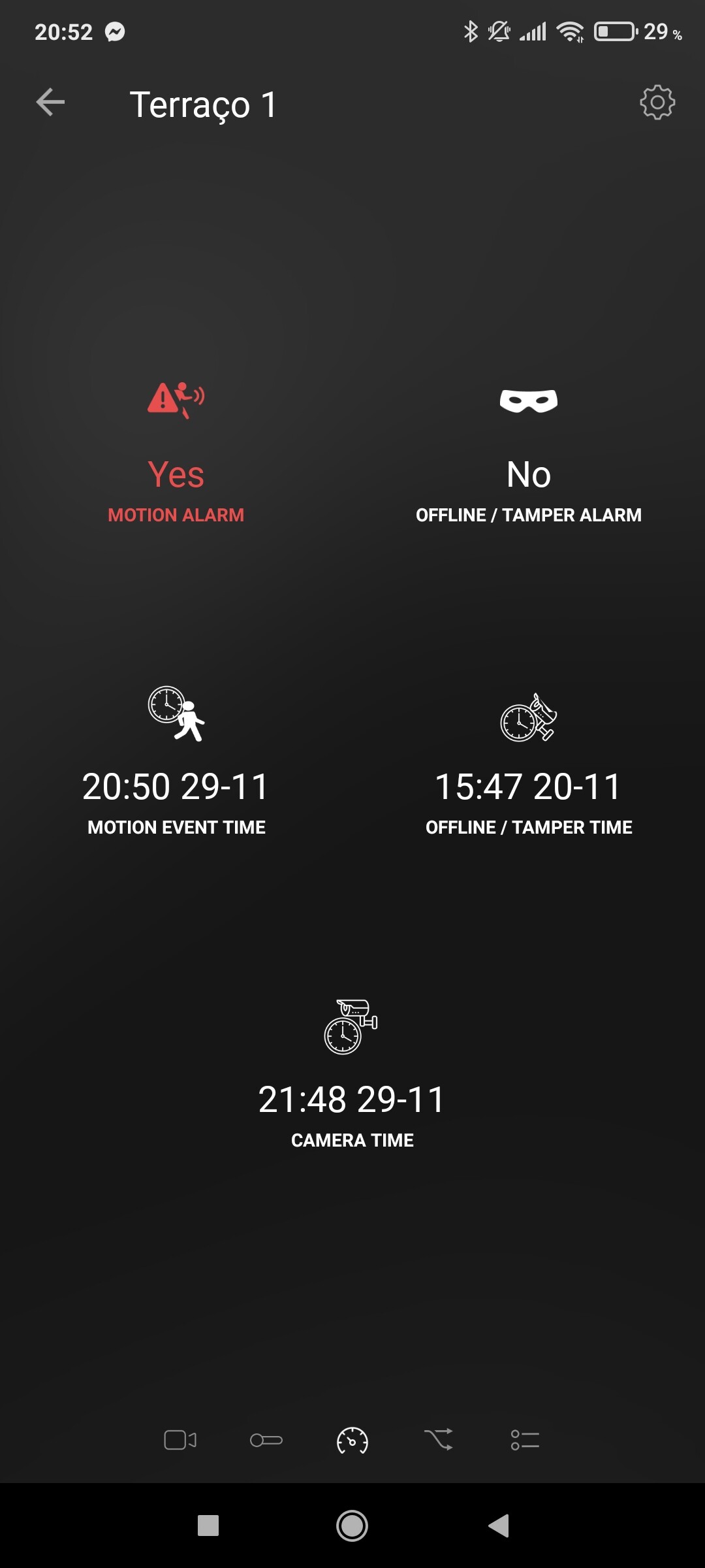

yes thanks got it working. added to homey now. I do not see the motion in homey yet
Hello Ricardo, So you motion is working in homey with the IPC-G26E? I have the IPC-G26E-V2 and it does not. We both run the same firmware 2.680.0000000.22.R Build 2020-10-24? All the other parameters are the same?
Hi @wesley_w
Snapshots are working?
When you enable motion on your camera in homey what do you want to achieve?
The way i see it in my own case, motion events are not reliable on homey cause i believe it triggers every time there is a slight change in the image, in Imou app it filters those events with the pir sensor, if the pir sensor triggers then Imou app notifies you about movement, but with it connected to homey with motion alarm active it triggers motion alarm on every frame change i believe.
But try to explain me better what you entend to achieve maybe that way i can be more helpful.

This can be done with imou cameras as well.
I say this cause my imou app doesn’t send me a single motion alarm if there is no one passing in front of the camera, but on homey it reports motion like every 2/3 or 5 minutes it’s random.
@wesley_w best select all txt and hit the </> button.

At the moment the app only reacts to MOTION and MOTION_ALARM. I will look into adding an option to select the events that trigger motion in the app.
I need a better way to display that as with so many events that type of field just can’t cope.
