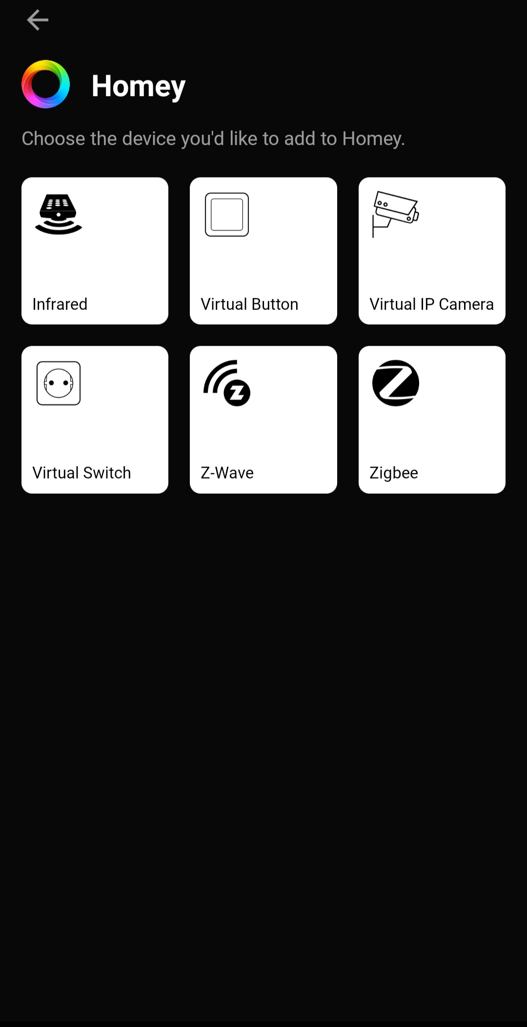

There’s is also the option to add virtual camera trough Homey itself.
But i believe this camera also doesn’t have this option.

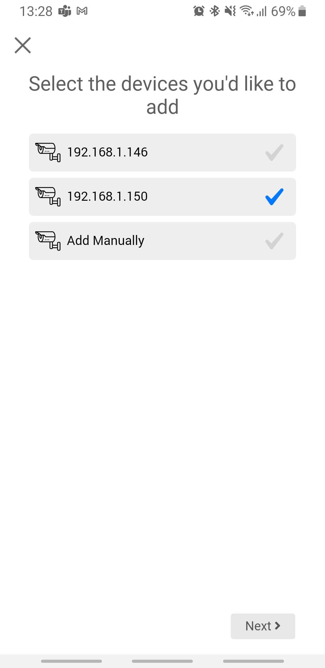

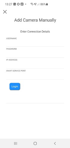

I have published a test version that adds the option to include a camera manually by specifying the IP address and ONVIF service port number.
When you go through the process of adding a camera, I have added a new entry to the end of the list for ‘Add Manually’. Tap on this entry and select Next. The Add Camera Manually screen will appear where you can enter all the details and then tap on Login. If the details are OK, the camera will be added.
Note: The camera still needs to support the ONVIF protocol.

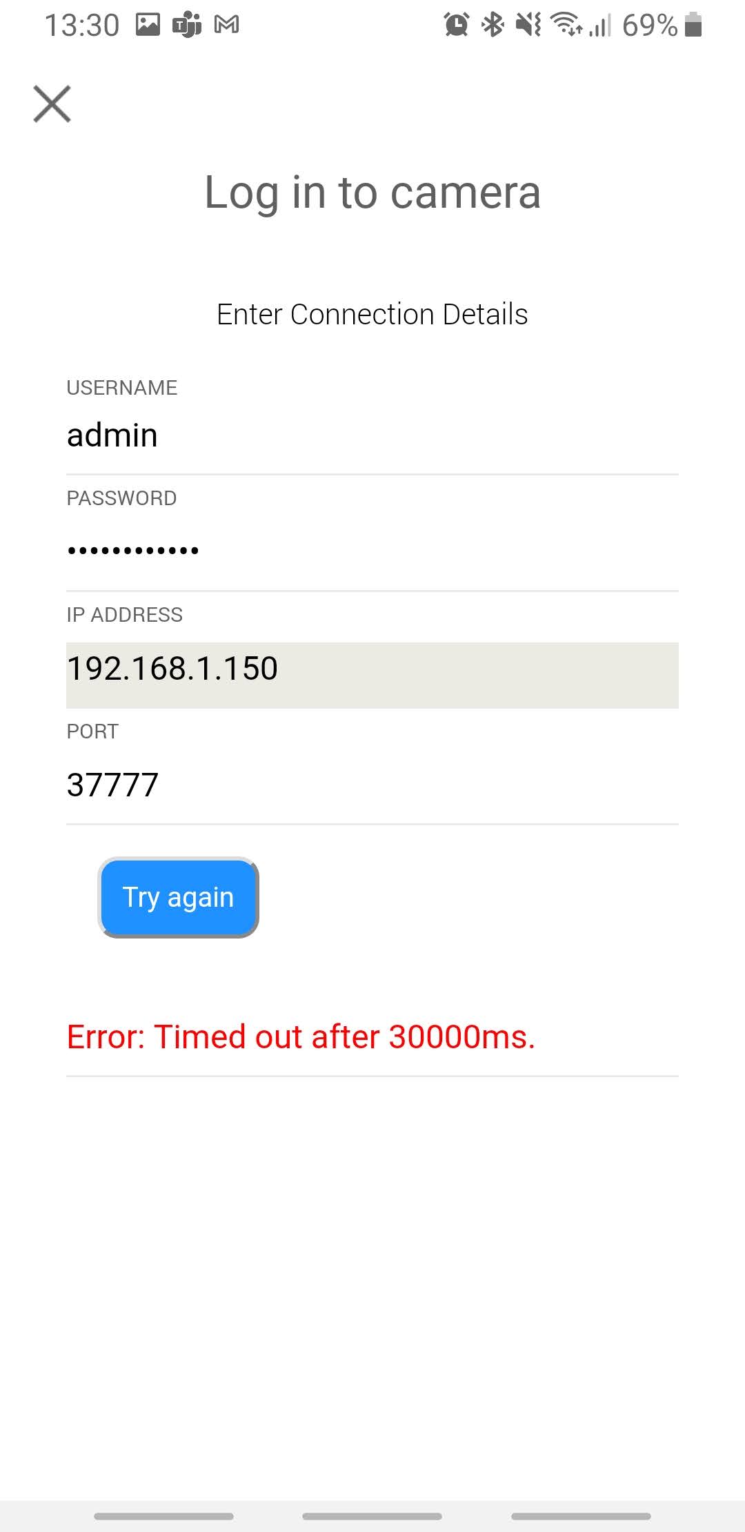

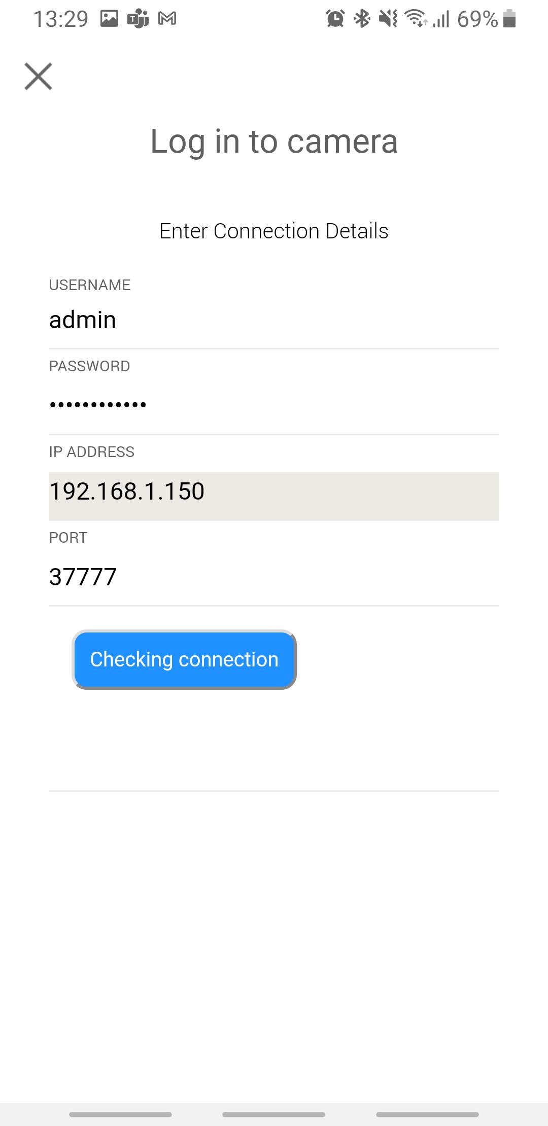

Hi, I have a DAHUA IMOU CUE 2 IPC-C22E camera, I can’t add it to the application at all. What am I doing wrong? The last image is from the camera application
Is the port number 37777 the one detected by the app or did you enter that manually?
After a bit of searching on the web it seems the ONVIF support is very limited and may only be available on certain firmware versions.
I think you will need to contact the manufacturer to find out if an update is available.
I received an unsatisfactory answer from support :frowning:This device can support as long as you add it on the IMou app. Then log in with the ONVIF client. The account is admin. The password is the one that you set when you added it on the Imou app. If you want to add to a third-party security system (such as AJXA Google Home), because we cannot control other people’s systems, you need to contact the corresponding technical support team to solve the problem
In Imou app I only see the IP settings and password. Port 37777 cannot be changed. In the Homey ONVIF application, I finally added the camera, but only the Tamper alarm works. Snapshot or motion monitoring on / off does not work. Probably the wrong camera (for the third time…)

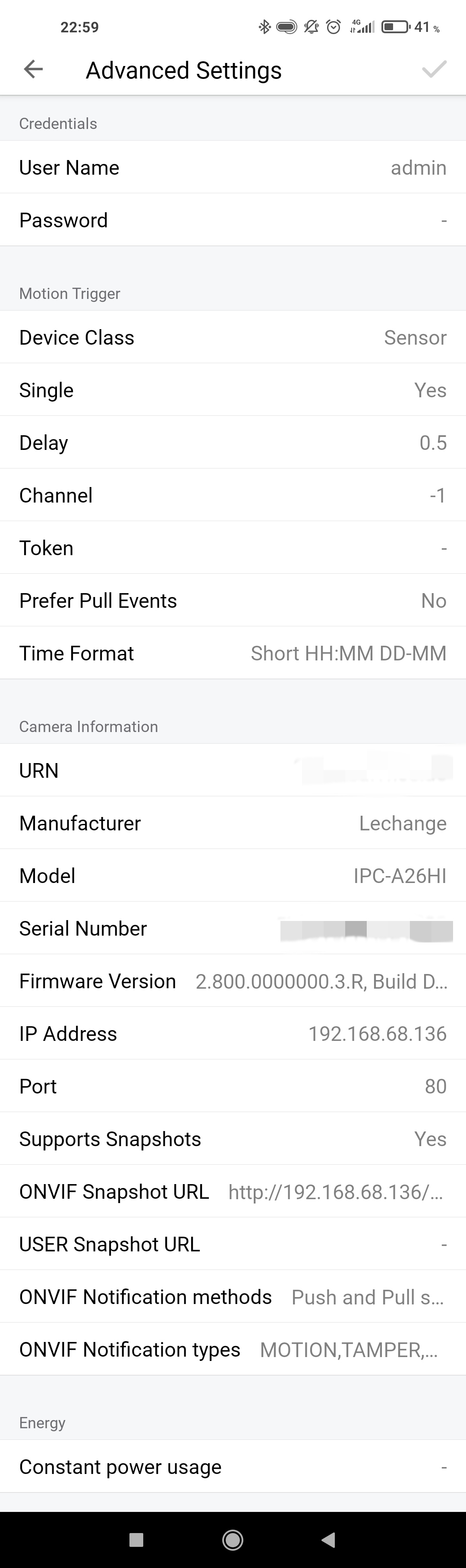

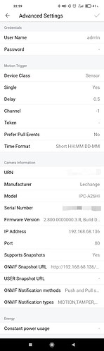

Hi Ricardo, could you please share screenshot of the camera setting? What port is used? Any of Imou cam. Thx
Hi @Daniel_S
I just have my cameras on same network as homey, with fixed ip.
Then i add the camera i want, and just type user usually it’s “admin” and password, i don’t type any port, the app just adds the camera itself and fully Working with live snapshot and motion snapshot’s as well.
These models i typed above are fully Working, the “cue 2” does not provide snapshot’s.
Anyway it atributes port 80
Here is a screenshot.

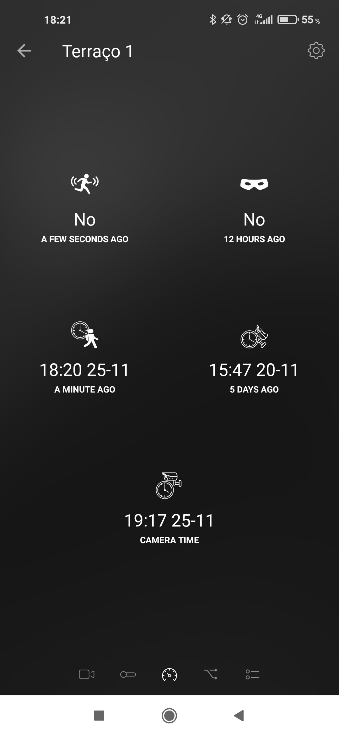

Boa tarde Ricardo. I’ve an Imou bullet (IPC-G26E) but I can’t get the alarms on active, therefore I can’t make flows. Can you confirm you get alarm indications in the homey screen of the camera?
Does the motion detection button (screen is selected via the second icon from the left, at the bottom of the Homey camera screen.
Obrigado.
Hi @ArtDijk (Boa Tarde :face_with_hand_over_mouth:)
Welcome to the community!
Yes, if i enable motion detection, then i have motion alarm alerts and can use them in flows if i want.

Dear Ricardo can you share your settings of the IPC-G26E?
My IPC-G26E begins with some different ONVIF Notification types then what you show for the A26HI version.
