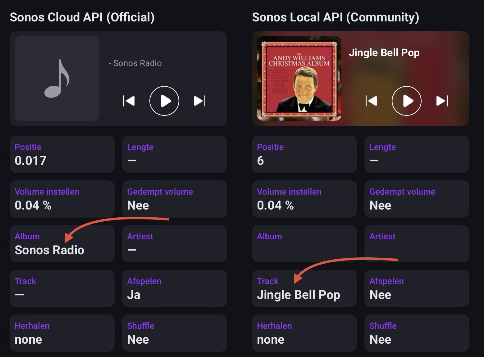

1 - The Playing (‘Afspelen’) tag always displays No in this integration, while in the official integration it shows Yes when playing and No when not playing.
2 - When starting a track via another controller (not Homey), the Album/Artist/Track tags are not updated and the Track tag shows technical ‘bump_sonic_pre_pre…’ content.
3 - Album art only updates when triggering a change in content (like a radio station) from Homey (not via the Sonos mobile app).
The following screenshot shows 1, 2 and 3

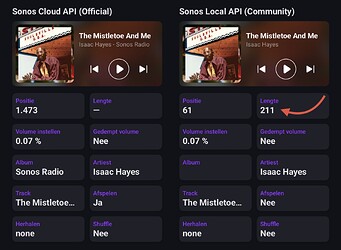

7 - The Length tag is not cleared when a song is played for which no length is provided (like a radio station). It keeps the length value of the prior song for which a length value was available.

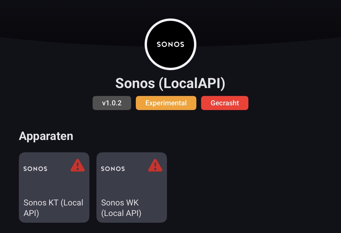

Unfortunately I am unable to install this version, as it keeps crashing. I have tried removing the app completely, but it crashes directly upon starting up.
Diagnostic report after reinstalling the app: c041a116-e5dc-4471-b3da-8ad7f36283d7.
Are you able to test v1.0.3? This version should fix the crash.

Yes, the app is up and running again! Thanks for the quick fix.

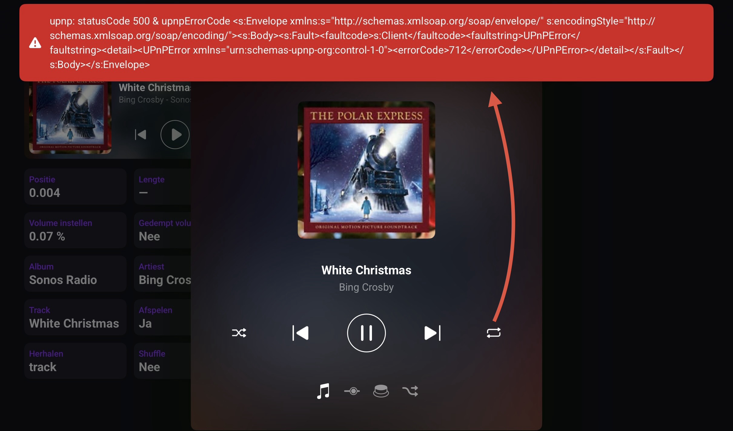

Sorry for spamming you :blush:. Some additional observations regarding the Shuffle and Repeat function.
When playing music for which repeat/shuffle is not available, like playing a radio station, tapping the Repeat of Shuffle button results in an error message.
Repeat:
Shuffle:
Note that the official cloud integration allows you to click those buttons and enable those functions, without doing anything of course. Which is also not what you want, but at least it does not cause an error.
No spam at all! It’s very helpful feedback. You should now be able to press the buttons without error messages. Below are my comments on the issues you mentioned.

4 - This now always shows a fixed label ‘Radio’ in the Track tag and the station name in the Artist tag, when playing a radio station sourced by TuneIn. However I expect it to dynamically display the online service name, if available/provided (like ‘Sonos Radio’). Also, the track and artist info is not shown. Further, when I use Sonos Radio as a service (instead of TuneIn), this ‘Radio’ label is not shown, instead the actual artist and track info is shown. So this does not seem to work consistently :cross_mark:. Also see below my remark on the Album, Artist, Track tags.

7 - In my case the Length tag sometimes keeps the value of the prior song and is not cleared when switching to e.g. an online radio station (that, I assume, does not provide length info). I haven’t figured out yet in which cases this tag is cleared and when not :cross_mark:.
