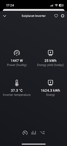

hey yes it seems like it registers the house’s power. attaching pictures from the solplanets app and the solplanet app in homey. there it shows that the solar panels give a little over 1400w and when the solar panels give 479w. when the panels give 479w the app in homey shows about 690w which is what the house consumes
