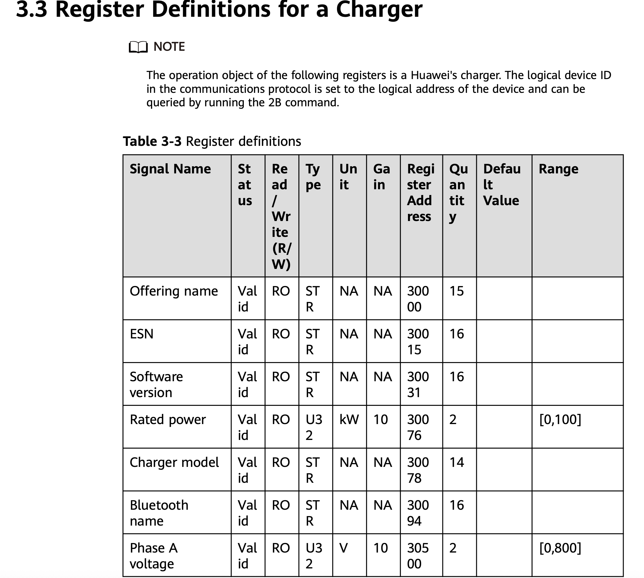

With Huawei Emma + Huawei EV charger installed, is there any way to control EV charger with modbus? And is that something that could be added to the app?
I havent seen modbus tcp documentation for Emma and it seems impossible to find.

doc = SmartHEMS V100R024C00 MODBUS Interface Definitions.pdf
