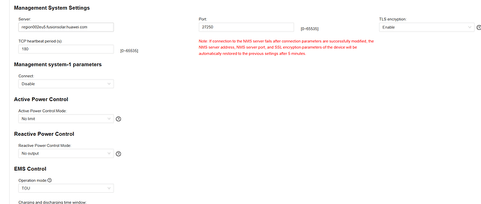

Opening a ticket did the trick. Obiviously some configuration in the inverter needed to be updated.
Hi Edwin, thank you very much for this app, works great for my setup with Huawei+Battery. A question, in the test-version of the app it says that we can change “Storage forcible charge/discharge”. I doesn’t seem to work atm in the test version for me, but does that mean that we (in a future release) will be able to force charge/discharge and not only use the app as “read only” regarding the Huawei batteries?
hey, did you disable the auth on modbus or be on lan I think? also when you use s-dongle it can be that s-dongle is the issue here. it is cheap but cannot handle multiple connections, even normal reading is already a challenge.
If you got a vpn connection , we can try it out, see what works and look at s-dongle for any issues.
yes that is the setting, now I need to have a system to try it out to see if we have to change something or if it is the s-dongle.

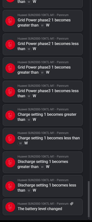

I’m using the Huawei 2 inverters s dongle device and when I try to create a flow “when” trigger I can only find the battery level changed card, all other cards are only greater than on less than cards. Is there no card for when the total power output changes for me to use to trigger my flows? I’m on the v3.0.169 of the app. Looking at the app page there should be four different changed cards only (power, power meter, voltage and battery level). So seems to be some difference to what I see in my Homey flows.
