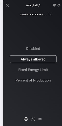

Hello, maybe somebody can help out here. Since a few weeks I am not able to charge by battery from the grid. Maximum charge power seems to be identical with the PV production (see picture).
Maximum charge setting is 5000 W.
Storage Charge/Discharge mode should be correct. It worked before. Storage mode is “Remote”.
What am I doing wrong here?

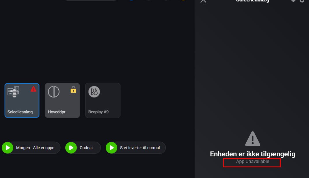

This morning the app was unavailable all of a sudden.
I have no issues with other apps but only this one.
I’ve tried to install both regular and test version but it doesn’t install on my Homey.
What the heck is going on?
sometimes solaredge changes something from their side.
Can you check this
But I heard it before, else make a support ticket.

no clue. what is your device/inverter?
you can try restart homey, or use main app. that did not change for 4 weeks.
or add the same device again see if that works.
plus send me a report
Hi again Edwin - thanks for the suggestions.
Although I tried to restart Homey, several times that didn’t work initially.
But now it has solved itself for some odd reason, so no need to take aciton.
Thank you again for your great work and commitment :slight_smile:
It was set to “Always Allowed”. With “make a support ticket” you are referring to Solaredge, correct? Will do that.
yes , can also you have to do a battery test again and maybe the night batch will alllow it again.
maybe this helps charge battery from the grid · Issue #57 · biemond/solaredge.modbus · GitHub
