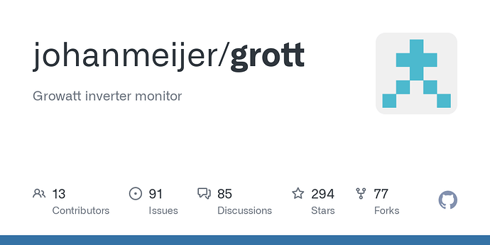

I might have found a solution (I have not tested it yet) that does not require a modbus to ethernet adapter. Someone developed a piece of code that intercepts the communication between the inverter and the Growatt server (man in the middle, or sniffing). And converts it to an MQTT message:
There is also a docker image:
https://hub.docker.com/u/ledidobe
Interesting stuff, but you need to have a server / nas / raspberry pi running docker.
