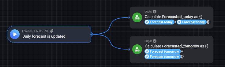

How do i combine the 2 sites to one total value?
Want to use the sum of the 2 arrays to get a more “real” forecast, have 2 directions, south and west. Must be rather simple, but can’t find it.
Just use a variable and make a flow to make the sum of those values. (which triggers when one of them changes)
ok thx
can you share an example picture?
