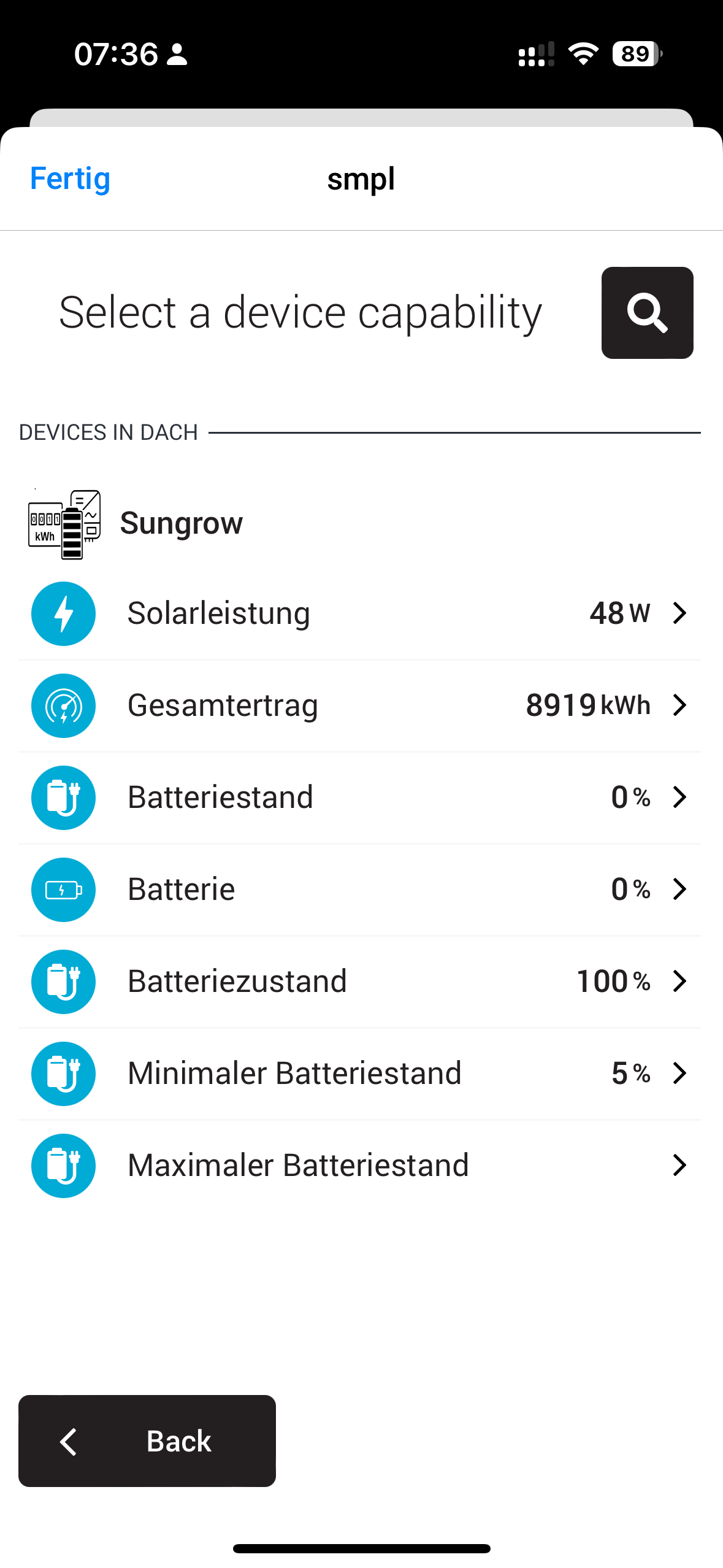

I have the problem that when I want to configure a display layout, I only see 7 entries and have no scroll option. As I have a device that has 27 values, I can’t get to the lower ones.
I think that is a bug. Do you know what browser you are using on your device? Maybe you can try in the web app: My Homey
That was the first thing I tried. On the web I’m also unable to reach the lower entries. In both cases I used the Safari (mobile, desktop). Will have a look on Firefox/Chrome on the Mac soon.
Used to stay with just 7 to select.
