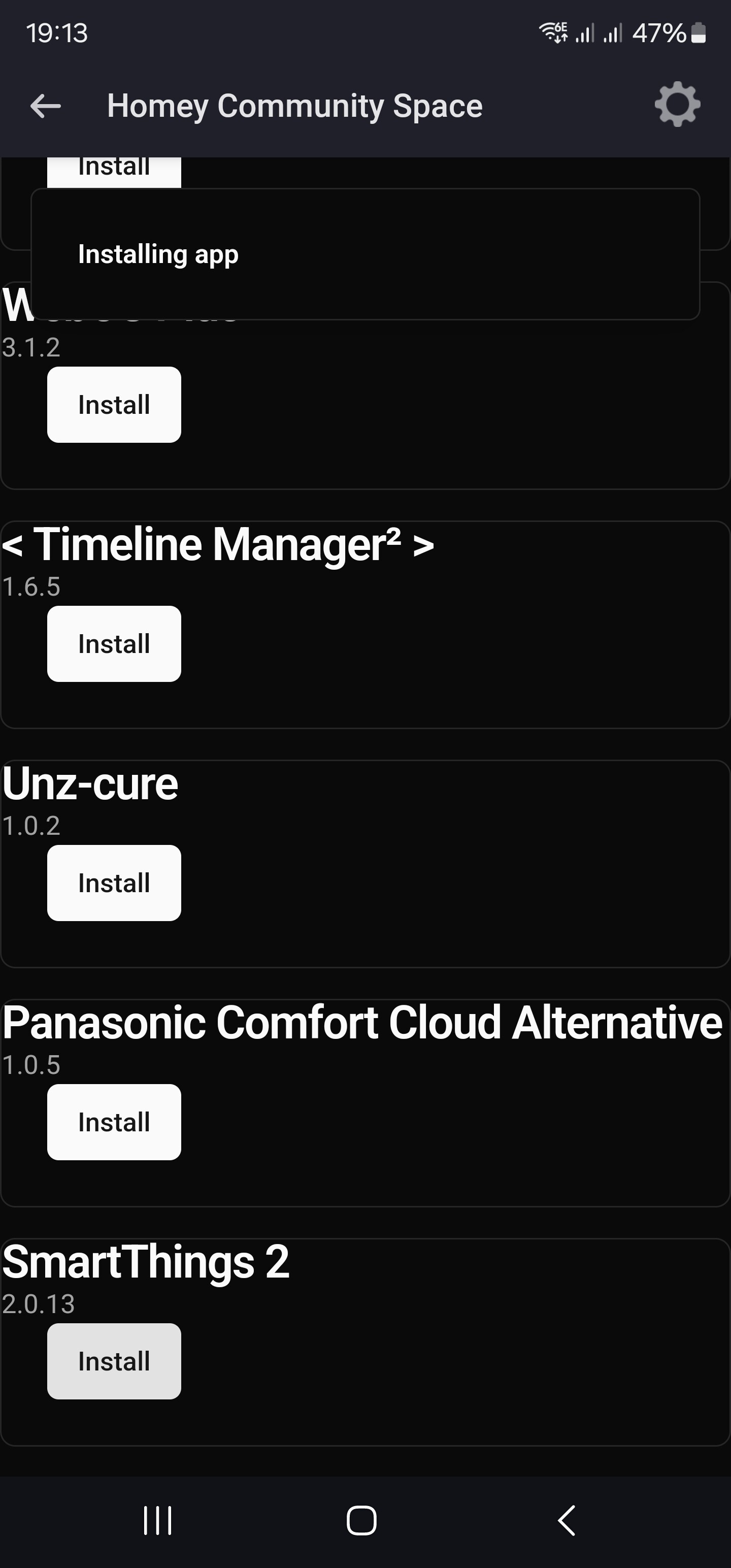

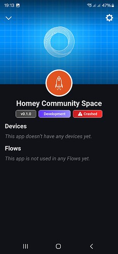

Hi all, when i try to install ST2 then HCS app says crashed, dont know why :frowning:
Where to find some logs to see whats happening?
Vitek
Is the HCS app that’s crashed or the ST 2 app?
When i click install, says installing, when i go back, crashed, and ST2 is not installed, so HCS is crashing when installing ST2
I did test to install panasonic app, crashed too…
Phew, that’s me off the hook :wink:
Can you try installing from the web page to see if that works?
Okay, after uninstalling HCS and installing again via Windows installer, SC2 works :slight_smile:
