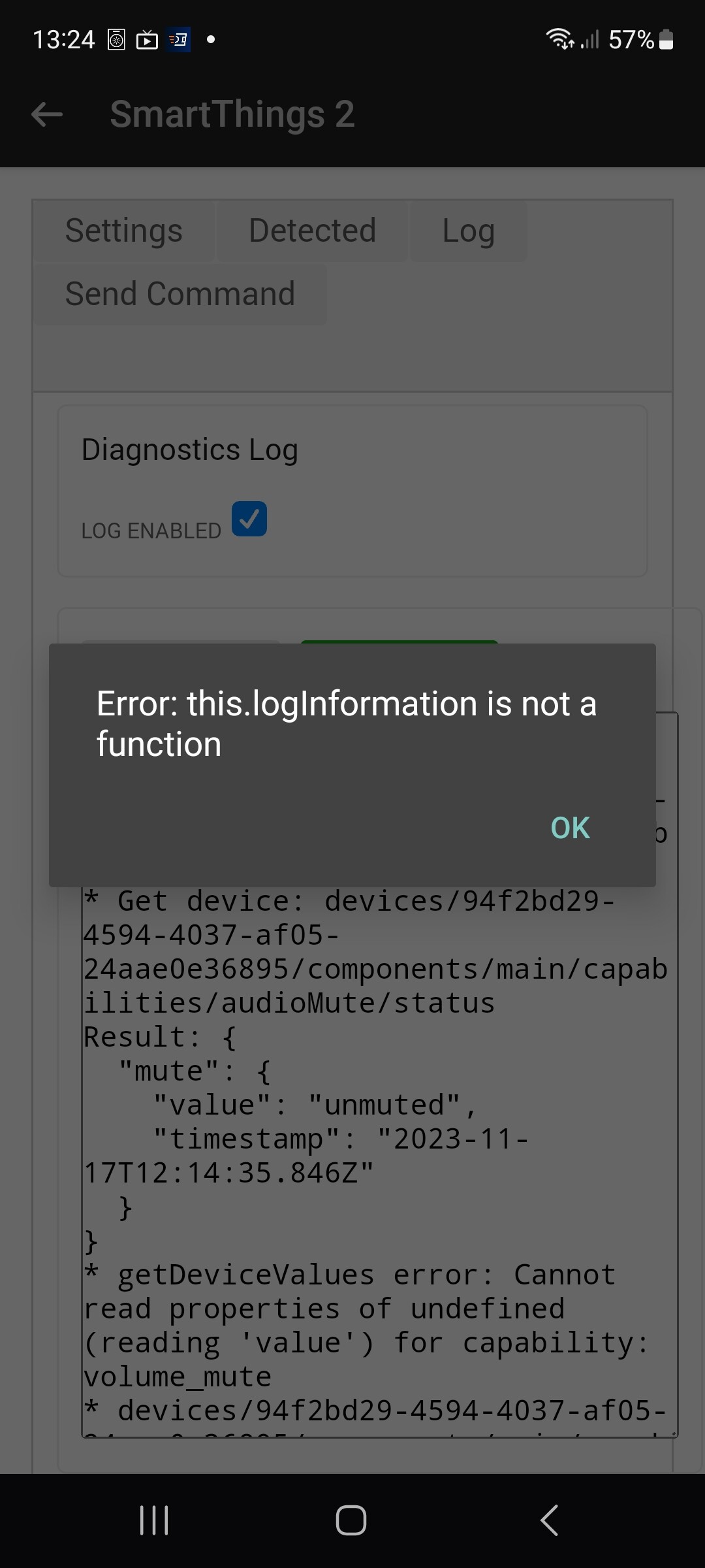

I did al steps you asked but when I click send log I get this error,
Hmm, OK I will look into that. Could you copy the contents of the log panel and send it via a PM?
The log has been send by PM.
Thanks.

Try now if you can send the diagnostic iog, I expect that to be fixed :wink:

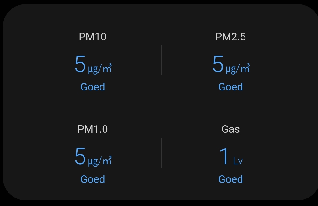

Is it possible to add air quality to air cleaner?
If you send me the log from the Configure App screen then I will look into that.
