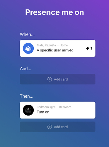

Hi. My Smart Presence not working. I’ll try to disable WiFi to simulate a “user left” mode and enable WiFi to simulate “arrived” mode. I created a two flows for “user lest” and “user arrived. I am an iOS 14 user.
And you waited for the 900 seconds?
Yes. But I’ve set Away delay to 10 seconds too.

Does the “tile” for the Smart Presence device become grey if you change to an IP address that is not in use in your network ? You have to wait until the “away delay” has passed.
And it should not be grey if you use the IP address of your router in the network, ending with 1, e.g. 192.168.10.1.
Hi. My IP address has 192.168.1.xxx I’m not sure which “tile” you mean
You are a “user” in Smart Presence and you have created a device for your “user”. It appears as a tile/device in your list of devices in mobile app.
