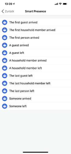

Okay, your description was confusing because I didn’t have a card “A specific user left”.
I have the following cards to choose in the " When…" section:
But I guess that we use different App versions, right? I use the v0.6.3.
I also don’t understand why the description of the card I have to use is like this:

The “A specific user arrived” and “A specific user left”- triggers are per device triggers, while the others are “global” for all devices.
All triggers have a “Who” - token, with the name of the device as it was when it was added.
No, that was the problem. I used only the cards out of the Smart Presence App… ![]()
