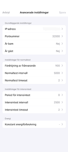

I’ve got a static IP for my phone set in the router and MAC-adress not changing in the phone. My settings attached below.
Please share the log including the english description of the device and the timeline, ideally replicating the behavior, eg. in case you have many devices the logs might be not long enough to see what happened.
Hi, I don’t know how to find the log.
The most interesting thing is that I’m marked as away 6 minutes AFTER coming home and reconnecting to my router. It seems that the app already decided to mark me as away and then does it without checking with the router again…?
Maybe you’ll find the log @ app configuration / settings.
Apologizes, I meant share the log using Smart Presense App - Settings - Create diagnostic report. Without seeing what exactly got detected, it’s hard to say, however the detection works for several thousands of devices, so it will be something specific to your setup.
