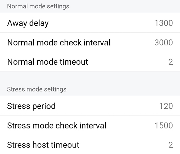

Anyone know the perfect setting for an IPhone 11? My android is off course working like a charm, but my wife’s iPhone is all over the place even after turning the delay up…
I do not know if it is the perfect settings but it works fine with an Iphone 11
