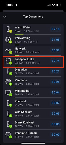

Sidenote; now with the new energy tab available, it would be great if the total energy consumption of the EV charger would be tracked using the meter_power capability. Doing that will make the EV charger appear in the list of consumers.

Smappee’s dashboard is displaying the correct value too:
