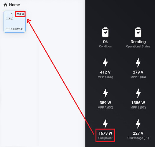

I have one question/request: would it be possible to show a different data field on the device icon? It now shows the power for my first string but I would like to see the total power of both strings (grid power). See screenshot:
In the Homey mobile app you can choose which property to show for a device. Click cogwheel of device to go to advanced settings and then click status indicator. This takes you to a list of properties you can choose from.
This seems to not exist for the Homey web app (yet).
