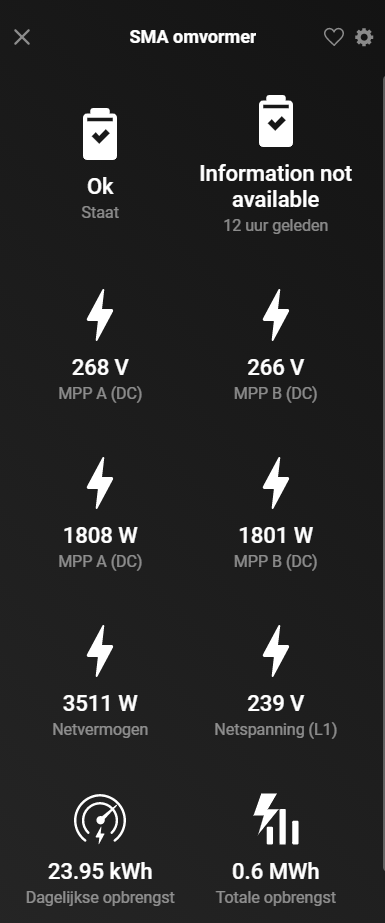

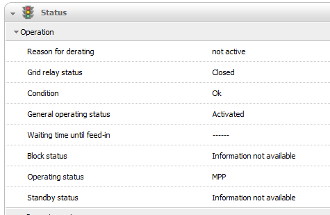

Hello, i have a Sunny Tripower inverter (STP5.0-3AV-40). Everything works perfect with the app, but the only information which is not updated is OPERATIONAL STATUS. It says: Information not available.
Is this parameter unsupported for this inverter?
Hi!
This should be supported.
Information not available is a status the inverter can return.
If you log in to the inverter using sunny explorer and check the “Instantaneous values” tab, what does it state as “General operating status”?
Hi, here is a screenshot with the fields from Sunny Explorer. And displayed in Homey.
Thanks, problem identified (I think). Missing statuses and a too wide condition for filtering out non desired 0 statuses.
It will be fixed in the next release
OK!
if i can help you with any other information just let me know!
Solved after receiving the update tot version 2.2.0 and doing a restart of the app!
