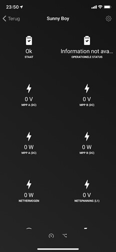

Installed this app yesterday for my new PV installation. The app works like a charm with my SB3.0-1AV-41. Does someone know why it keeps showing the ‘operational status’ as ‘information not available’? What should it be showing?
It should work for SB3 AV-41. Can you check which firmware version you are running. If you go to advanced settings (cogwheel top right corner on the screen you showed in the image, then advanced settings - there is a field called software version.)
These values should be available;

Thanks for the quick reply! See the screenshot:
The debug fault on the bottom of the screen was because of changing the IP…
Nothing obvious came up. Looked at newest modbus spec and field is there.
Don’t know if more users experience this problem?

Hi, I have a second zone on 1 of my inverter since yesterday. how can I read the produced of the zones separately ?
Thanks
Jeroen
Can you explain me what MPP A and MPP B means ?
MPP I believe stands for Maximum Power Point. An SMA Tripower inverter, for instance, has two MPP trackers with each 1 or more string inputs. In my setup, I have two strings of solar panels, 22 panels in each string. They are connected to string input 1 of MPP A and MPP B respectively. So I use both MPP trackers in my inverter, but only 1 of the 3 string inputs that each MPP tracker has.
Having the information available in the app means I can easily compare the output of the two strings since they are in the same direction and have the same number of panels.
I guess someone else is better suited to explain the concept of MPP in general :slight_smile:
Hi!
Not sure what you mean with zone? Using more than one MPP as per the previous question or you have more than one string on a single MPP?
Currently in the app I only split by MPP, not by string since there can be quite a few. My inverter has support for 6 strings in total as an example.
Thanks for the quick reply Richard :wink:
He Richard
Thank voor the replay.
I have made a picture of one of my devices. A you can see its has a MPP A and a MPP B image|233x500
But I can’t read them out with a flow or so.
Gr
Jeroen
You can use logic to call the value…
Depends what you want to do.
As Emil mentioned you can access the values in a flow using for instance a Logic card as both conditions and actions.
