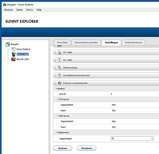

I have been trying to add my inverters to the SMA Solar Devices app, but the app cannot find them. If I look at the step-by-step guide the “tcp server” needs to be enabled. Which is not the case for both inversters.
If I open the inverters in Sunny Explorer and click on “edit” in the tab “external communication” the only option available is webconnect ON or OFF. There is no possibility to switch the TCP server ON or OFF. Any idea what setting(s) I am missing?
Maybe this more of a SMA-forum type question? I’d be happy with any suggestions.

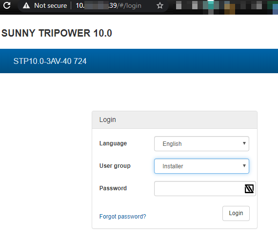

Find the same setting directly on the InverterUI by browsing the IP of your inverters directly. Login as Installer.

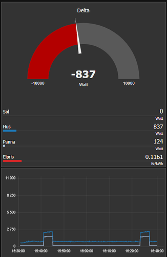

Just wanted to give you an idéa what you can do with the PV power. I have a tablet with an Node Red dashboard feed with Sun (sol), Total house (hus) and heat pump (panna) power toghether with the current electricity price (elpris) via MQTT from Homey.
The gauge is what you are doing with the homey. A delta with sun minus house. Negative value is when power is drawn from the grid and visualized in red. Positive values when sun production is greater than total house consumption and visualized in green.
The graph is just a 1 hour history of sun, house and heat pump.
