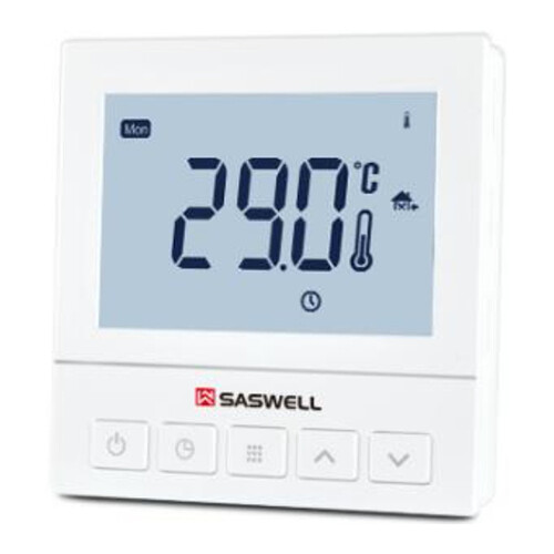

Thanks for the answer. I have only been buying thermostats since July. I bought three Saswell Wifi thermostats. I’ve tried getting them to work on Homey with Saswell’s own and Smart-E apps, but I can’t get them to install on Homey with either. I don’t understand what I’m doing wrong. I can see them in both programs (Saswell and Smart-E), but I can’t install them in Homey. Could someone give such a simple instruction that I would understand what is wrong with the installation.
thermostats are SAS921FHL-7W-WIFI (not SAS920FHL-7W-WIFI). Could that be the reason?

The problem is not the Homey mobile app. The problem is somewhere in the thermostat application, wifi router or Saswell cloud service. When I install the Saswell thermostat on a wifi network, it does not go through successfully. The wifi icon on the thermostat keeps flashing and the Saswell mobile app claims it is offline. the network is 2.4Ghz and judging from the router, the thermostat has received an ip number. What could be the problem?
