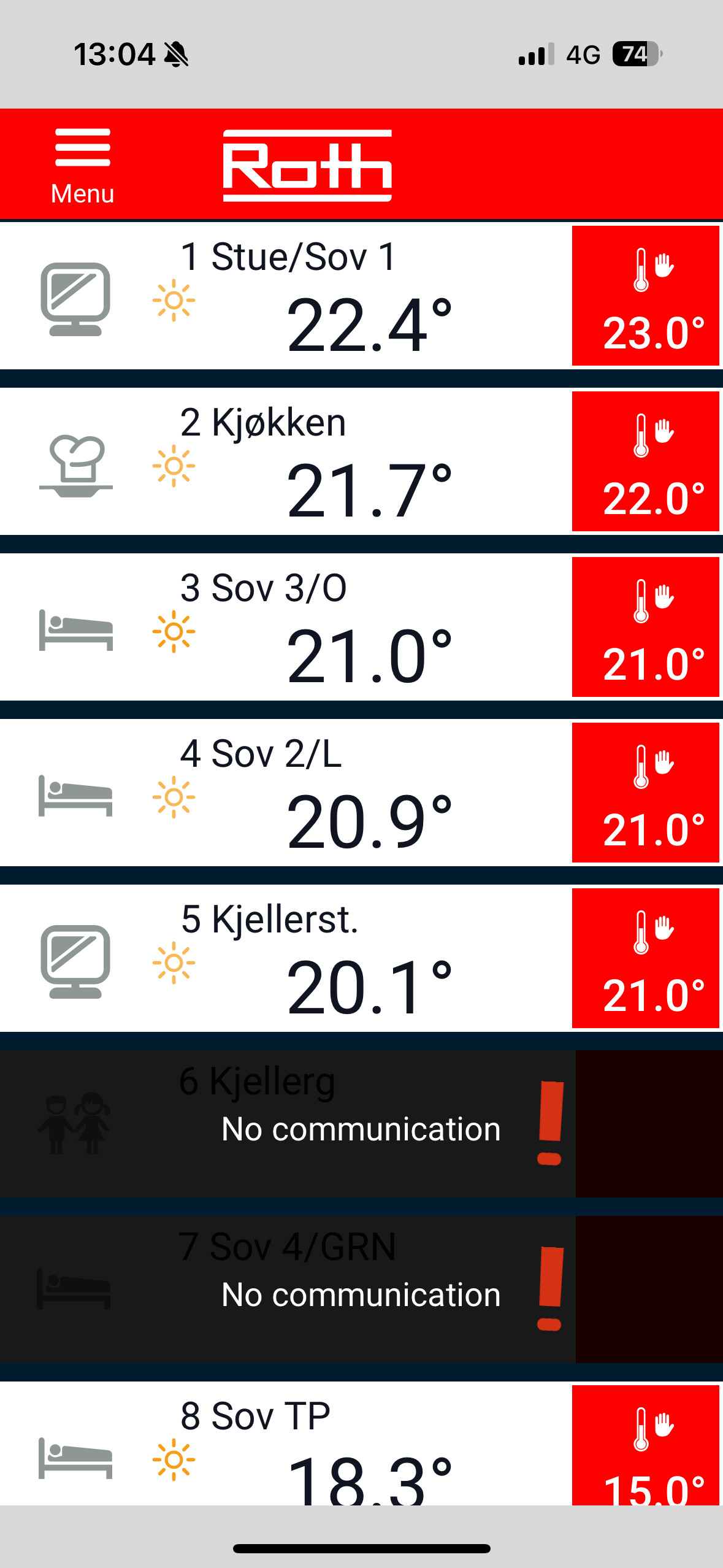

Is it possible to have the thermostat flag «not accessible» or something, or through a flow? Everything looks normal even if it is not accessible. Have to build a flow plus parameters and another app to show if it is online (no connection more than one hour). My thermostats goes from 100% to 0 without warning, but the Roth apps signals visually no connection.

I have tried the flow «Last seen» and have increased the time to three hours and still two of the sensors initiates the flow. Two of them one hour is ok and the rest keeps contact at least more often than two hours. The worst are those who are used in rooms that are kept cold (unused bedrooms) and that is understandable that they report the temp seldom.
What I need is something that triggers when a thermostat has really lost connection.
