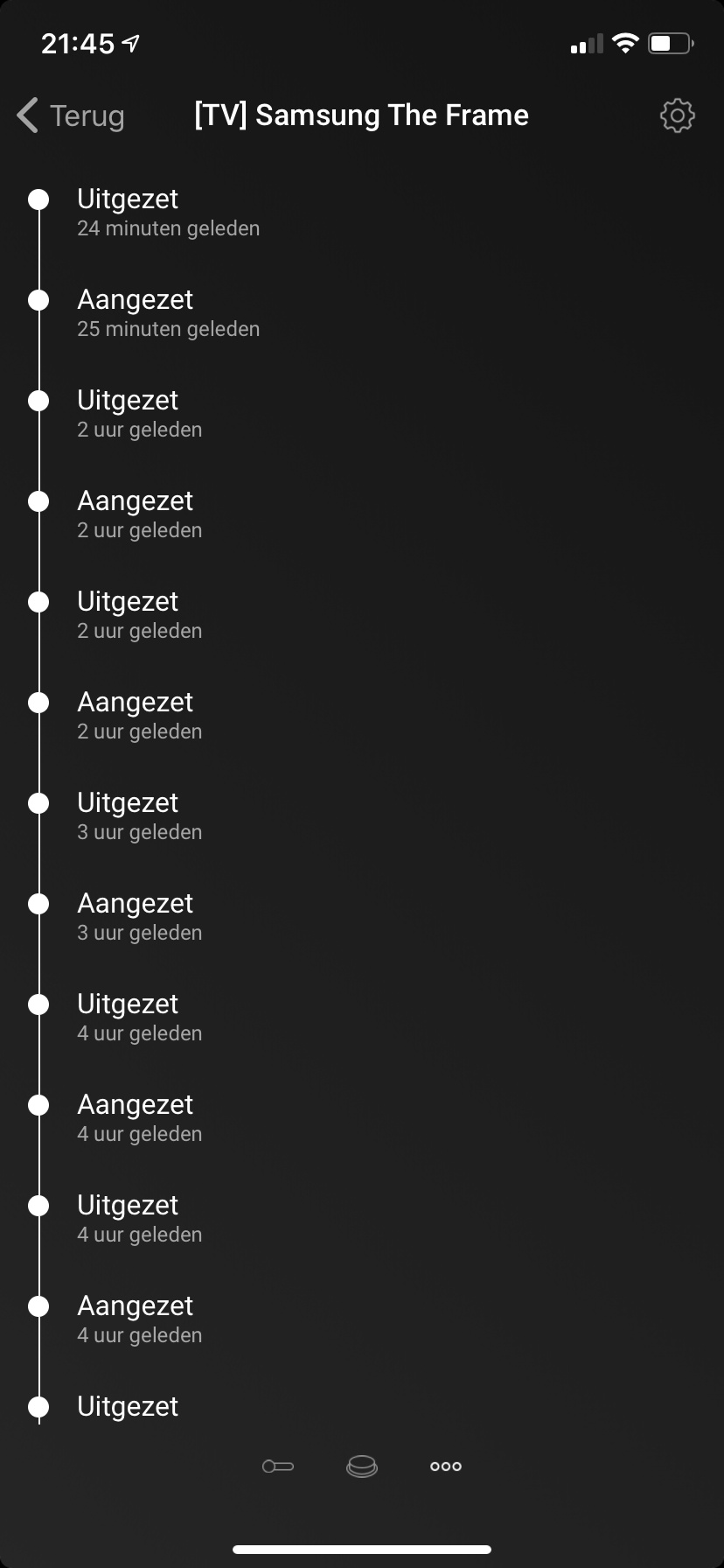

Hi all,
Does someone know a solution for my problem?
My Samsung the frame is toggling between on or off according homey. See added pic
I’m not using homey nor do I have active flows.
What could be the reason?
This is actually the network interface of the TV that turns on and off, even if the TV itself is not really on, and the app logs that state.
It doesn’t matter much, as long as you don’t use the On / off - triggers…
You can enable the SmartThings API (look on top of this page for instructions), and that behaves a bit better.
