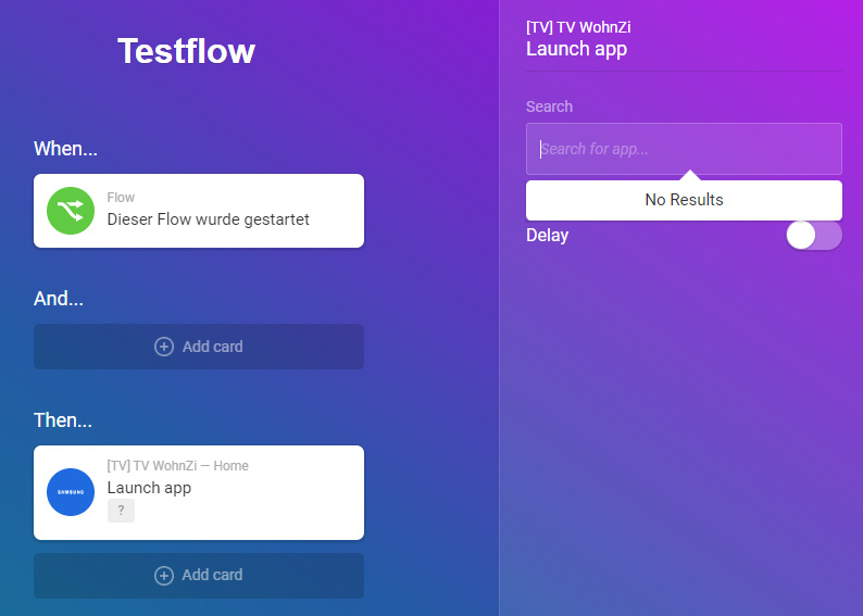

thanks for this great app @balmi ! so far everything works, except for the app selection (Launch app) I can’t see anything (2020 model). i have also entered the smartthings token. what am i doing wrong?
thx for help
