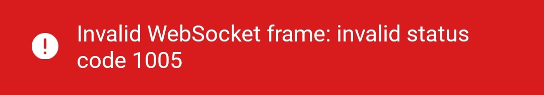

Edit2: I dont know what happened. I can now add TV to app and it works for like a minute but when I turn it on or off using app it stops working and gives me this error I scrennshotted above.
I made a report, in case dev wants to take a look: 39a6044c-00a2-4e00-ae6e-2f4929746b3b

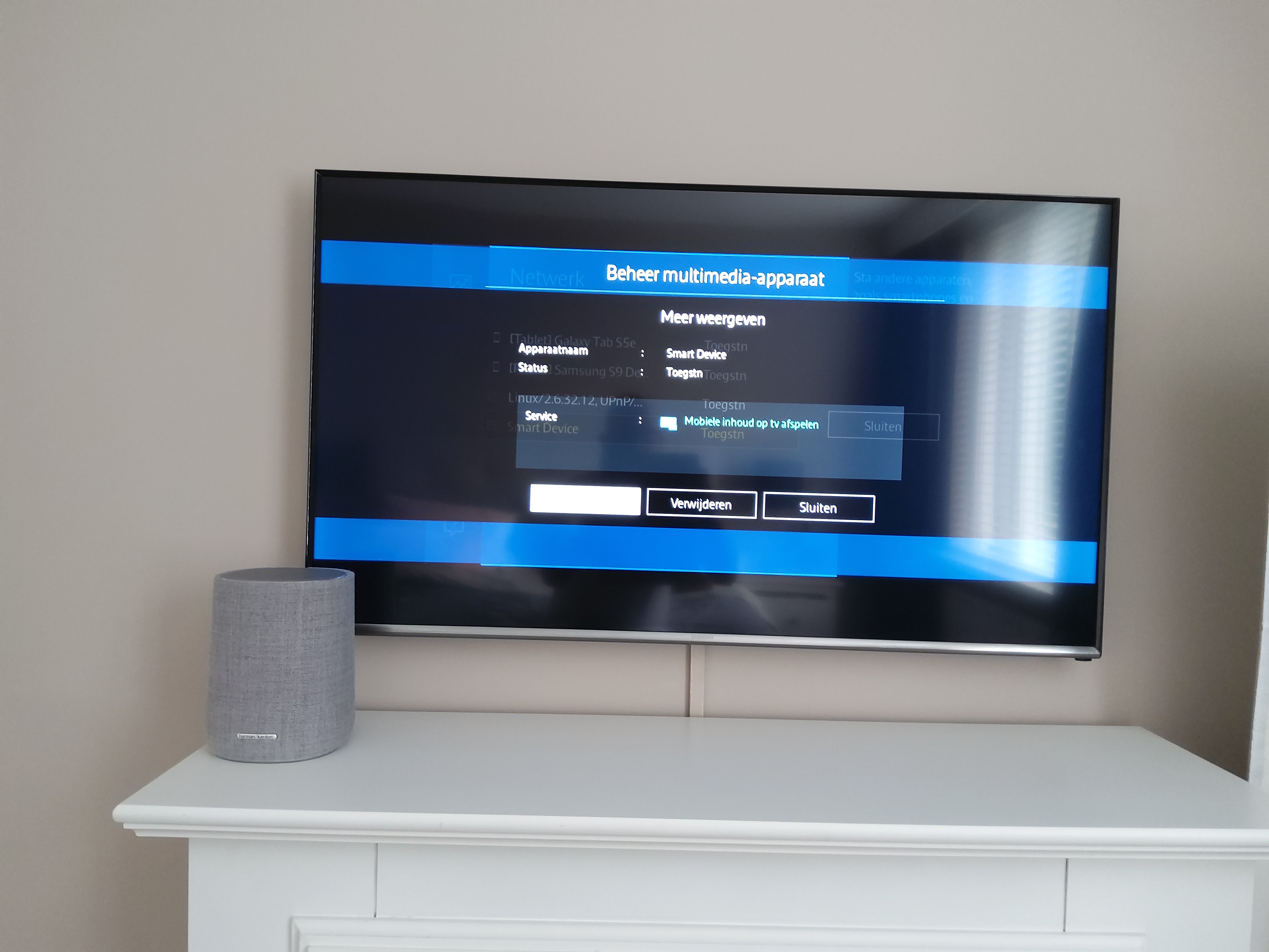

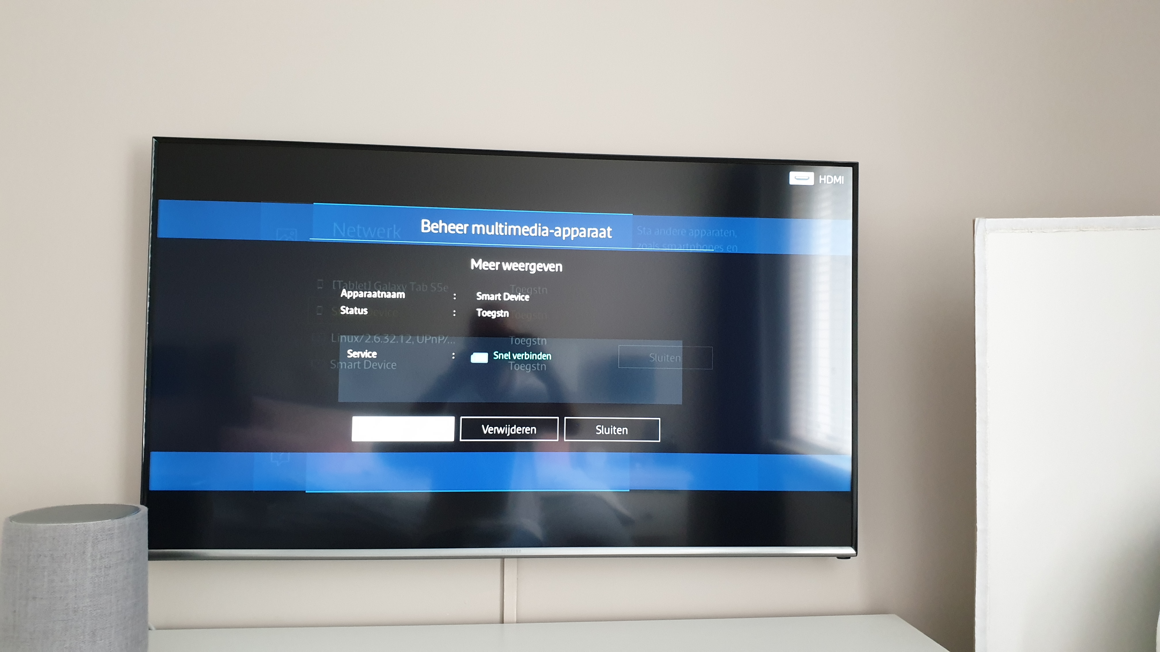

Then I took a look at the devices that were allowed to connect to the tv from the tv menu. And here I saw my S9 was allowed to connect and use the service “quick connect”. See the picture below. My phone or any other device gets listed on the tv only if you allow the service like the picture above shows. Now if I would click on Deny, I still get to enter a pin and I am able to control the tv, except… wake on wifi. If I connect the phone again and click allow and then enter the pin, wake on wifi works through the android app on my S9.
I wanted to make sure that there is a differcence on how Homey connects and how my S9 or Samsung tablet connect. So I removed my S9 from the list on my Samsung tv and tried to wake it with the Android app, but no luck. Then I connected my S9 through the Smartthings app and again before showing the pin, it asked something to allow. When I allowed it it shows the pin. The difference with Homey and the S9 or my tablet is, is that the S9 or my tablet gets a listing in the tv memory granting access to use the “quick connect” service, like in the second photo.
Homey is not in the list, nor did I get a message on the tv to allow or denny Homey something.

Now I do see (i think it is Homey) a device in the list on the tv richt after I added Homey with a Pin, only the service it uses is not “quick connect”, but “play mobile content on tv”.
Hope this helps to solve the puzzel.
