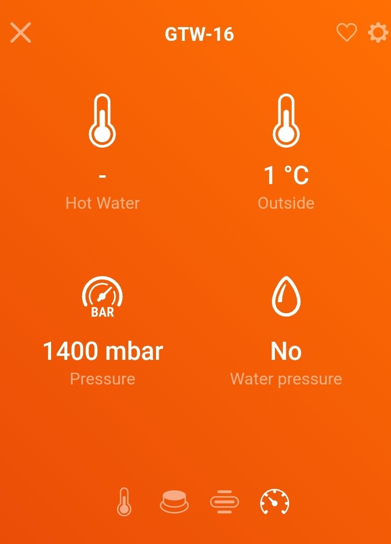

Why is there nothing shown under hot water and outside? I need those to switch on the fan
Hot water isn’t available in the API so this is normal. T Out should be there if you have an external temperature sensor installed connected to your Remeha
If you go to advanced settings and set ‘probleemverhelping’ to yes, you can read the latest API reaction. This is where the app gets it’s info. Look for Outdoor Temperature and see what it returns.
