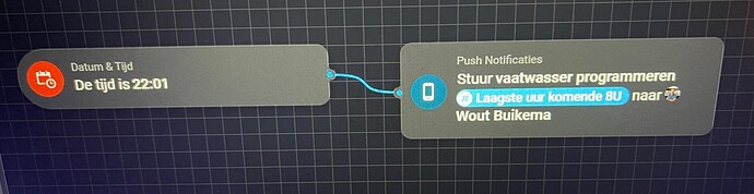

When i get a notification to run the dishwasher at lowest price in the next 8 hours it shows only 4 instead of 04:00.
Is this something what can be fixed?
I dont know what you mean. Do you have a screenshot?
With this flow i get notification vaatwasser programmeren 4.
This should be vaatwasser programmeren 04:00.
But also this night gonna test a flow for lowest price and run dishwasher (Home Connect) at that moment.
you can put 4h or add x0:00 if you need that :grinning:

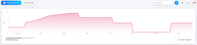

kWh this day seems to be a problem in this version:
It set to 0 at midnight but somewhere later on, it seems to be reset to the value of yesterday.
Damn. But lets wait a day longer. It might also be caused by the app updating to a newer version at that moment.

I had the same as @Walter_vande_kerkhof
It goes to zero at night and later on it adds the last value.
But with all the devices as far as I have seen.
Even with my Solarpanels. It adds for the KWh today the value of yesterday.
Let’s see what happens tomorrow.
My other devices look fine
I am having the same issues still
This is not correct I think. This is measured with the Energylink from Homewizard.
This screenshot is from a P1. It is a few minutes later.
Here are the testing results of today.
My standard solar panel summarizer seems ok. The newly added one shows a “kwH” dip at 16:00 and 17:00-17:05 and a “vermogen” dip and peek at 17:00-17:05. (App reset at 17:05). Don’t know why, maybe this device is not behaving correct because I created it while the app had a bug (version 5.0.5)?? I’m going to remove the “nieuw” device and add a new one to see how it behaves tomorrow.

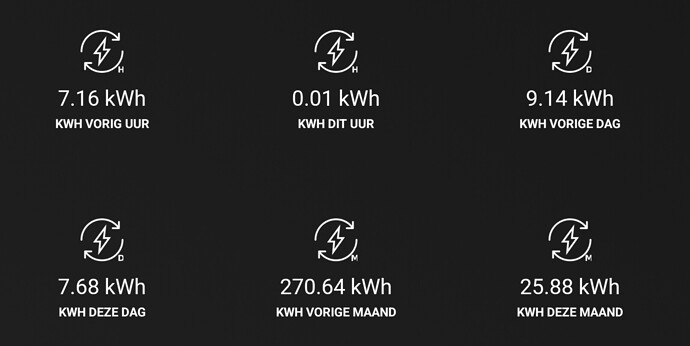

How should i see the calculation of 67,2% of usage this month and year?
I have used this month/year til now 29,73 kWh
For gas it is 4,62m3 and a usage of 15,5%.
I am on version 5.0.9
Maybe i have missed something.
Thanks.
I did read that but for 3 days i may use about 32 kWh and i used 29,73 kWh. And the whole month is 339 kWh
How will that get 67,2%
I think i am missing something.
Edit
On the screenshot it says This day 7, 74kWh and the usage is 67,2% and a total use of 25,8kWh in 3 days. Because it is the third day, it says This day is 7,74kWh.
But in the calculation is already taken the fourth day I think. Then it is 4 days at ca 10kWh. 25,8/40=64%.
So I think These day wasn’t reset to 0 at 0:00 so that is were it went wrong for me.
I hope I did explained myself clearly.
