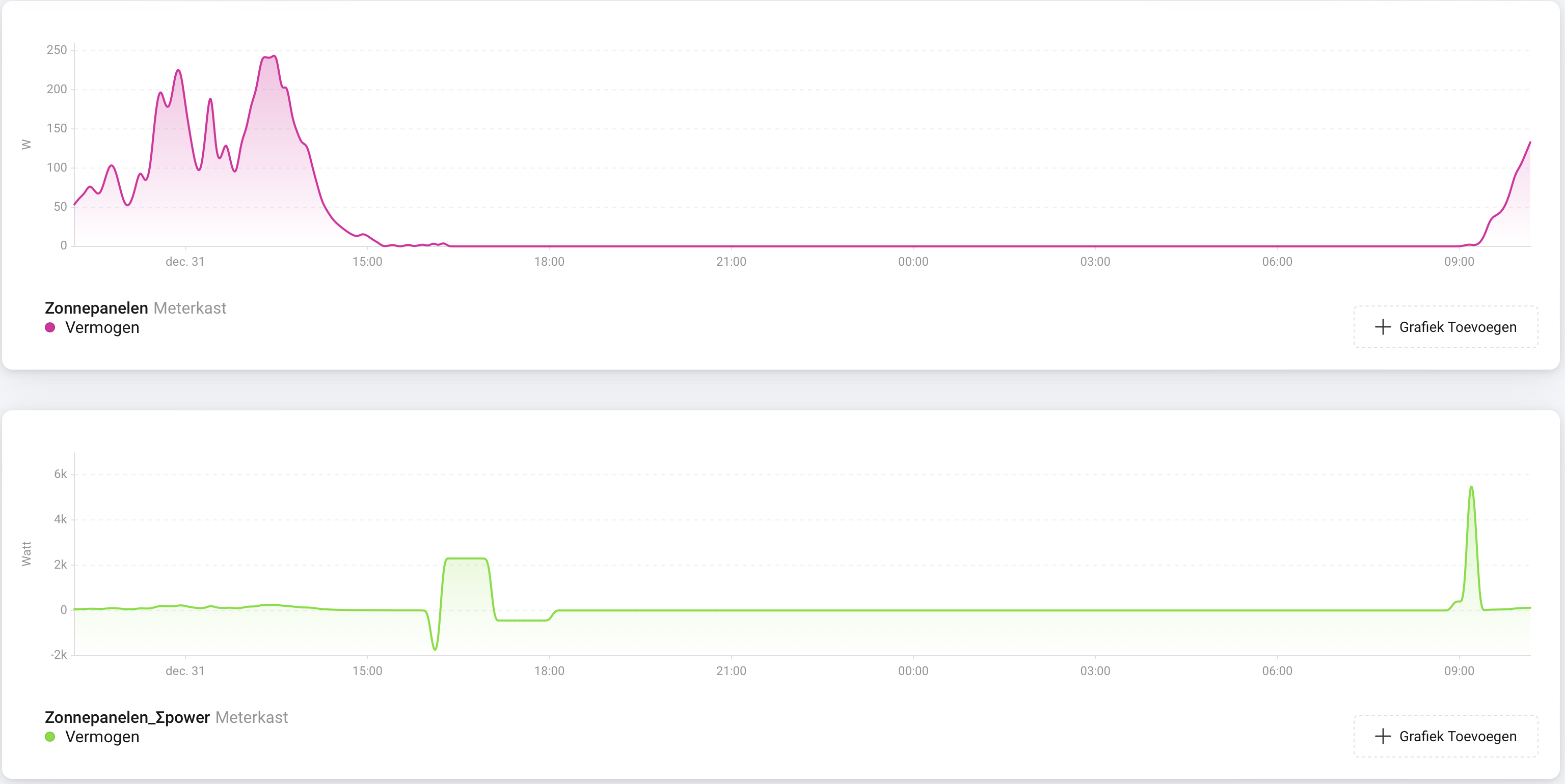

Second, my first findings on 5.0.5. Behavior is different now
First graph is of the ā€œsourceā€ (Youless on S0 of dedicated kwh counter of solar panels)
Second graph (green) shows strange behavior between 16:00 and 17:00 (the moment the solar panels stop delivering power) and also at begin of today (around 9, the moment the solar panels start delivering power).

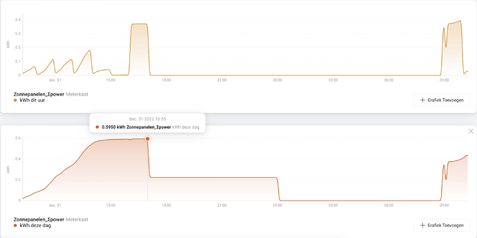

Third en fourth grap show this same behavior. Strange is the loss of energy at 16:55 from 0.5950 to 0.2230 kWh (=0,372).
Let’s zoom in on last 6 hours.
Second graph, strange dip (-2369W) and (longer) peek (6308W) between 9:03 and 9:21.
Third graph, strange behavior around 9:00. Big jump to 0.374kWh, looks like it’s taking back the energy he lost the afternoon before at 16:55?
My findings:
All graphs are in sync but ā€˜kWh deze dag’ starts with 0.75 kWh, a value ā€˜received’ at 5.00 am. before that, is was zero from 00:00. And before 00:00, it was 0.75 kWh (see graph below)

Result for today:
I added a second device (… Nieuw) to look for difference in old and new added device. Old device has some more kWh because of false start in the morning (see my post above)
First ā€œvermogenā€ goes down, as a result of that, kwh_dag goes wrong.
