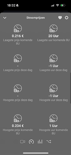

Sadly I have to stop using the “Price +x h” possibility’s
For the 3rd time those values where incorrect.
The values from 17:00 till 00:00 tomorrow I could corrected by the PbtH JSON files.
And again the remaining prices of today are ruined by importing the prices of tomorrow.
Now the upcoming prices are not identical, but not correct. The graph cannot be shown and the highest/lowest prices are no longer available for today.
Could you please have a look at this issue? It is the third or fourth time this happened this year.
Please let me know if I can help test something.
Edit: app v6.6.6, homey 10.4.1. Sent a diagnostics report.

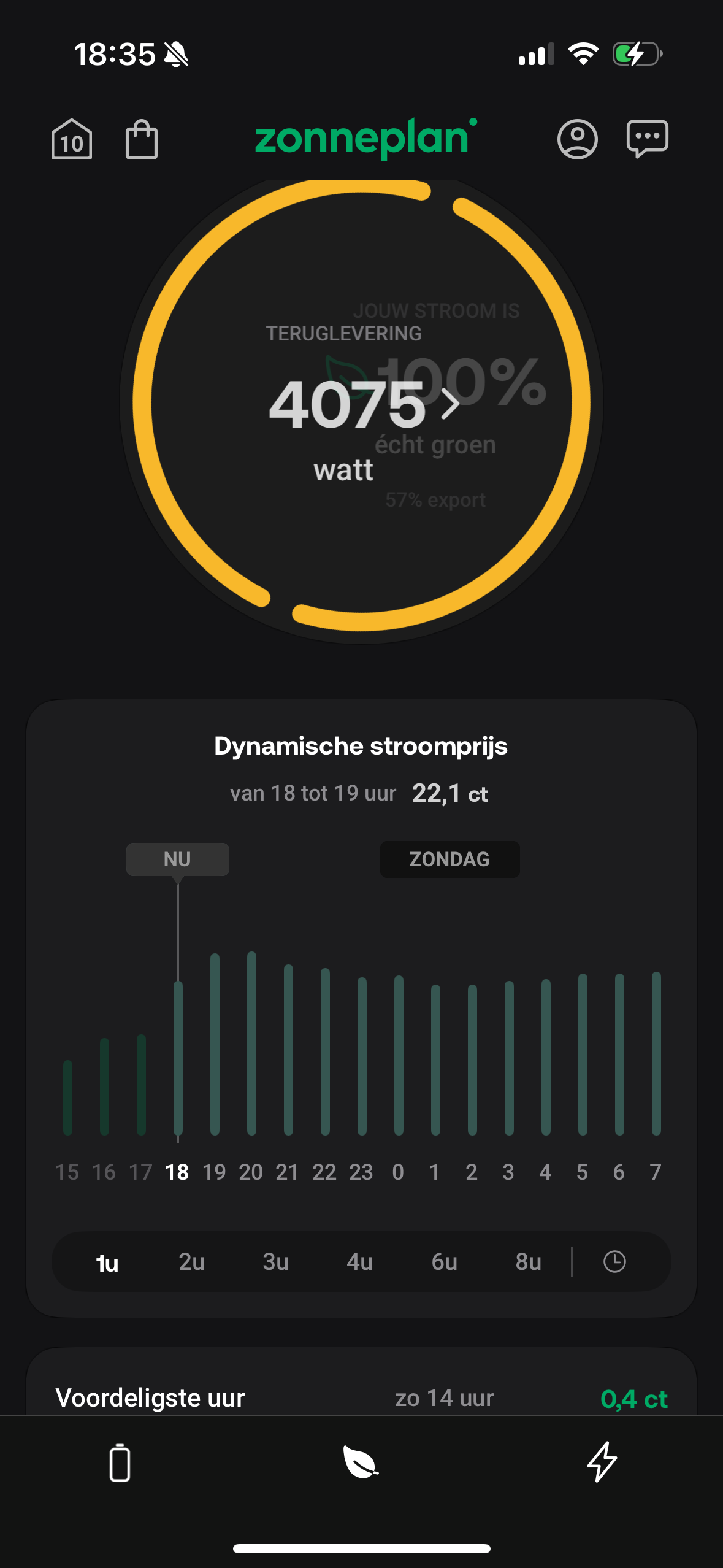

I see…
Tax = 0,1228
Zonneplan = 0,0200
Total per kWh = 0,1428 euro
Now the prices in PbtH and on the website of Zonneplan are identical.
Thank you!

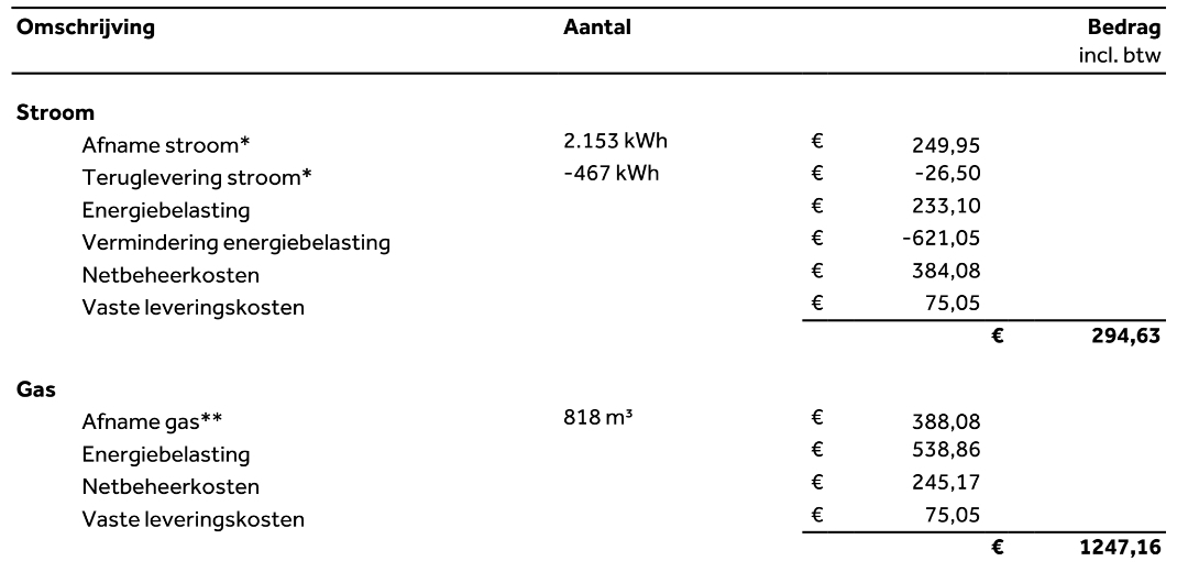

I only wonder why your daily rate is 1,23 while mine is 6,25 euro.
C’est la vie :innocent:
I’m curious why it’s even higher for you?
Liander tariff 2025 (for max 1 * 40A or 3 * 25A) (without Gas):
384.08€
 75.05€
_______+
459.13€ / year
  Divided by 12 = 28.36084€ / month
  Divided by 365 = 1.25789041095€ / day
Only I don’t understand anything about the Energy Tax and Energy tax Reduction “witchcraft”, being 233.10€ -/- 621.05€ = -387.95€
Am I right this means I have
365/387.95= 0.94084€/day less fixed costs?
I still don’t calculate with this number.

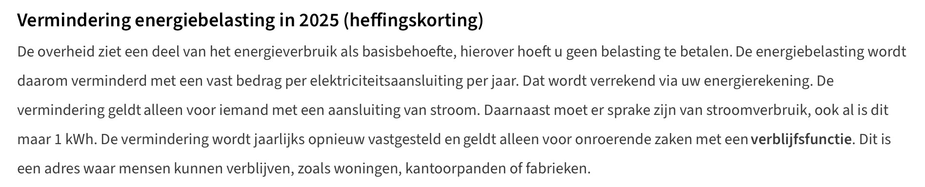

Less taxes, as part of your energy usage is considered a basic need and hence exempt from taxes in NL:
Source: Energiebelasting in Nederland in 2025: hoe zit het?
Hi Peter, There has been a reduction in energy tax in the Netherlands for years. This is because electricity is a basic need. This means that this year you will not pay any taxes at all over the first 4,000 kWh hours.
