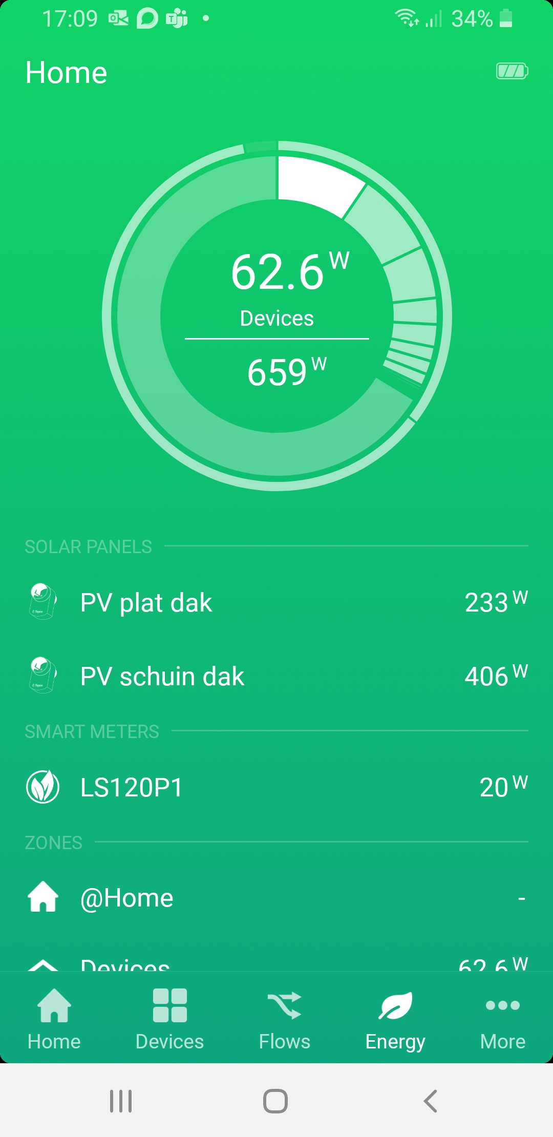

Ah, I see what you mean. You need more advanced reporting. In the Homey energy tab it does work well though, but only real-time when you open the energy tab (so no hindsight reporting available). In below example my solar panels produce 233+406=639 W. My P1 meter is reporting a total usage of 20W. So the actual usage is 20+639=659W. And this is correctly shown by Homey.
For this to work you need to monitor the solar production seperately. I’m using Plugwise Circles for that, but other solutions exist as well.

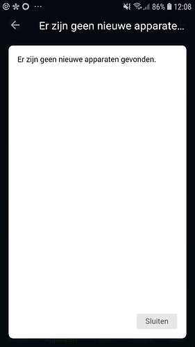

Hi guys. Just received my smile p1 :sunglasses:. IInstalled it and works with the plugwise home app. Next step was to add it to homey, but first installed the smile app from you “Gruijter”. I went to add device, plugwise, smile p1 v3, install device, recognition of the smile name, asked to provide the 8letter of code and prompt it shows " er zijn geen nieuwe apparaten gevonden" with a close button at bottom right. Finally not added the device… did a restart of homey, tried multiple times to add and looked for updates…
Can anyone advise?
Cheers tim
Maybe the autodiscover doesnt work in your network. In that case you need to enter the IP address manually.
Hi. Thanks for the quick reply. The auto discover works since my smile is recognised by homey, correct smile - …numbers… message appears after clicking and filling the id (8 letters)…

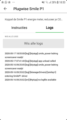

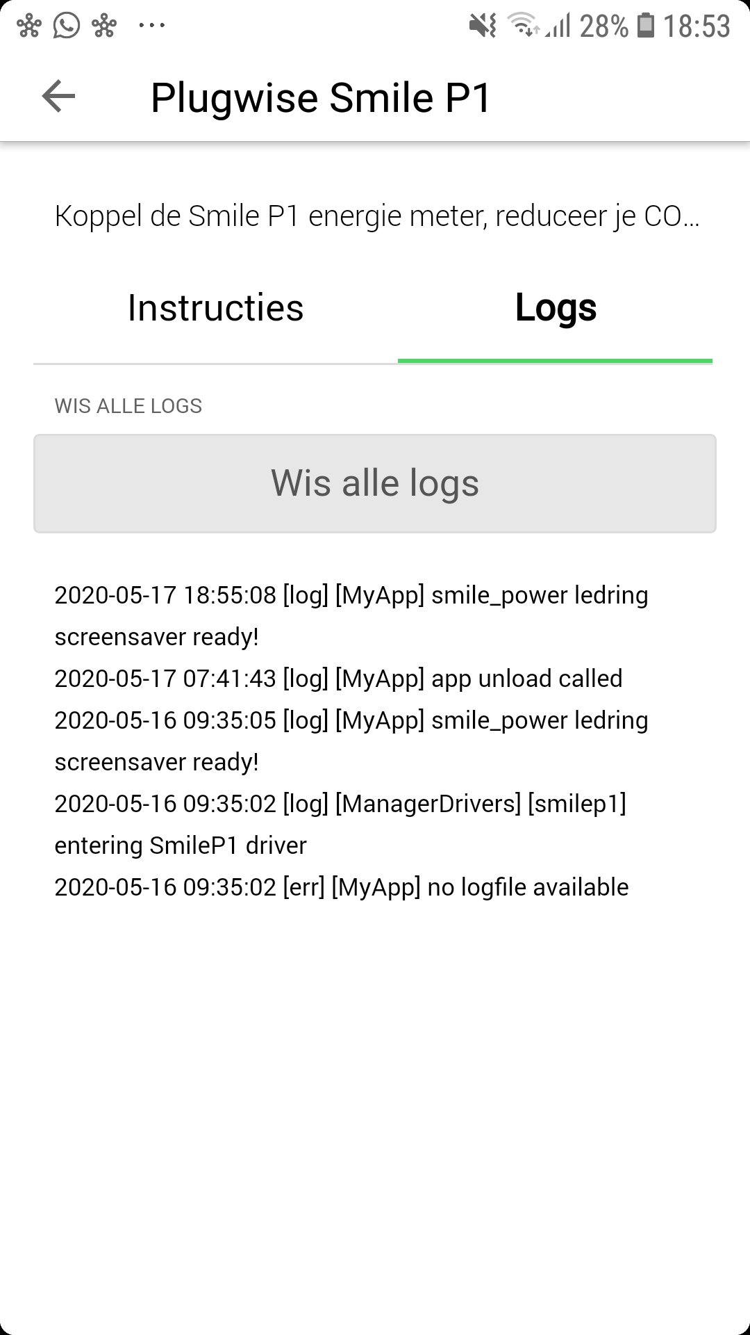

Can you post the app logs here?

Hi! Thanks for all the help so far. See attached. All the screens plus log from your app.
Haven’t tried the update, will do tomorrow.
Works! I think not by the update but you triggered me to look for add device and I in my stupidity clicked on the plugwise smile p1 instead of yours… . anyway thanks and hope it helps to prevent others doing the same…
