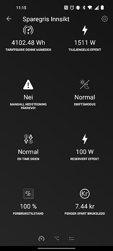

After last update I’m not getting any information in Sparegris.
I’m using mode “Fra flytkort” in the app.

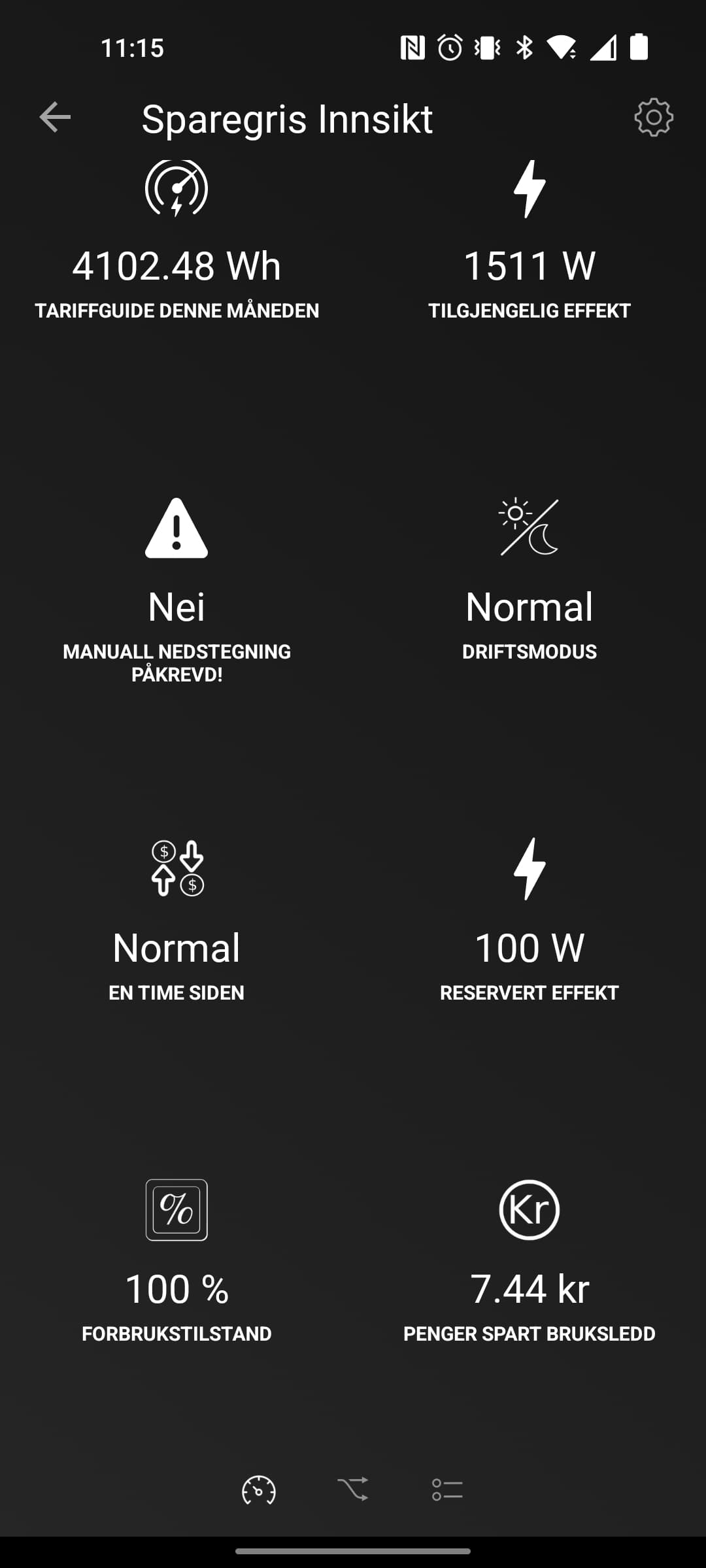

The information i get from “Sparegris innsikt” looks like this:
The unchanged flow looks like this:
Sparegris2
Are there a bug in 0.12.1?

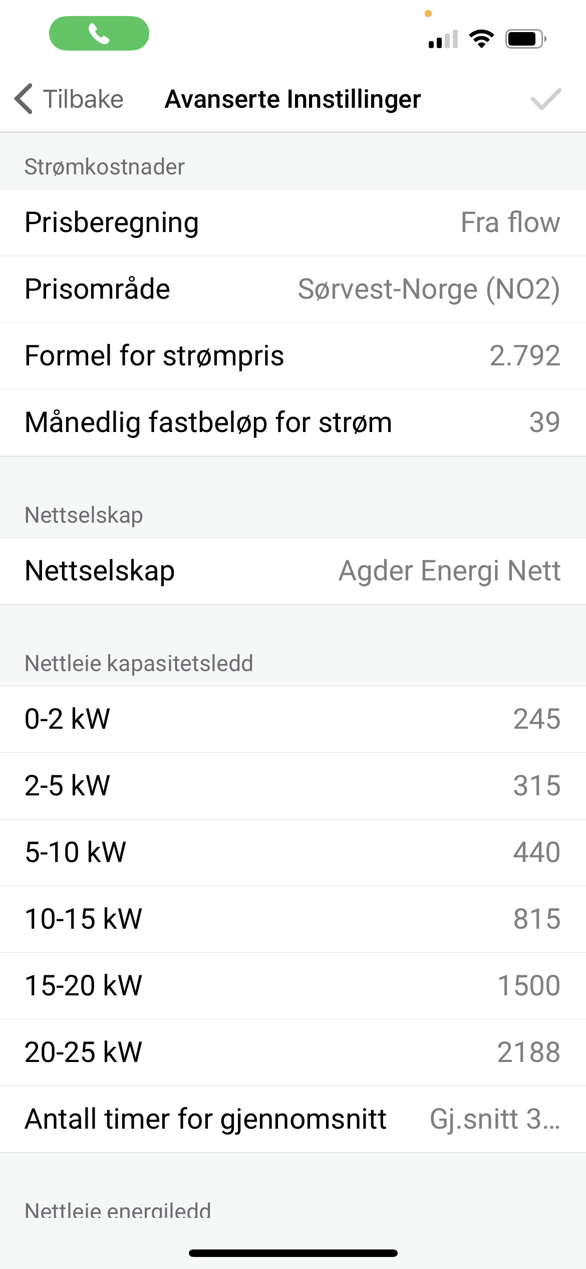

It is not referring to that flow, it’s the flows that adjust the prices. This message should only appear when the price is selected to be fetched from the Strømregning app as follows:
And the configuration in the Strømregning device is set as follows:
If this is not the case for you then there is a bug but if not please give me directions on how to make this clearer so it is understood that the problem is in the other app.

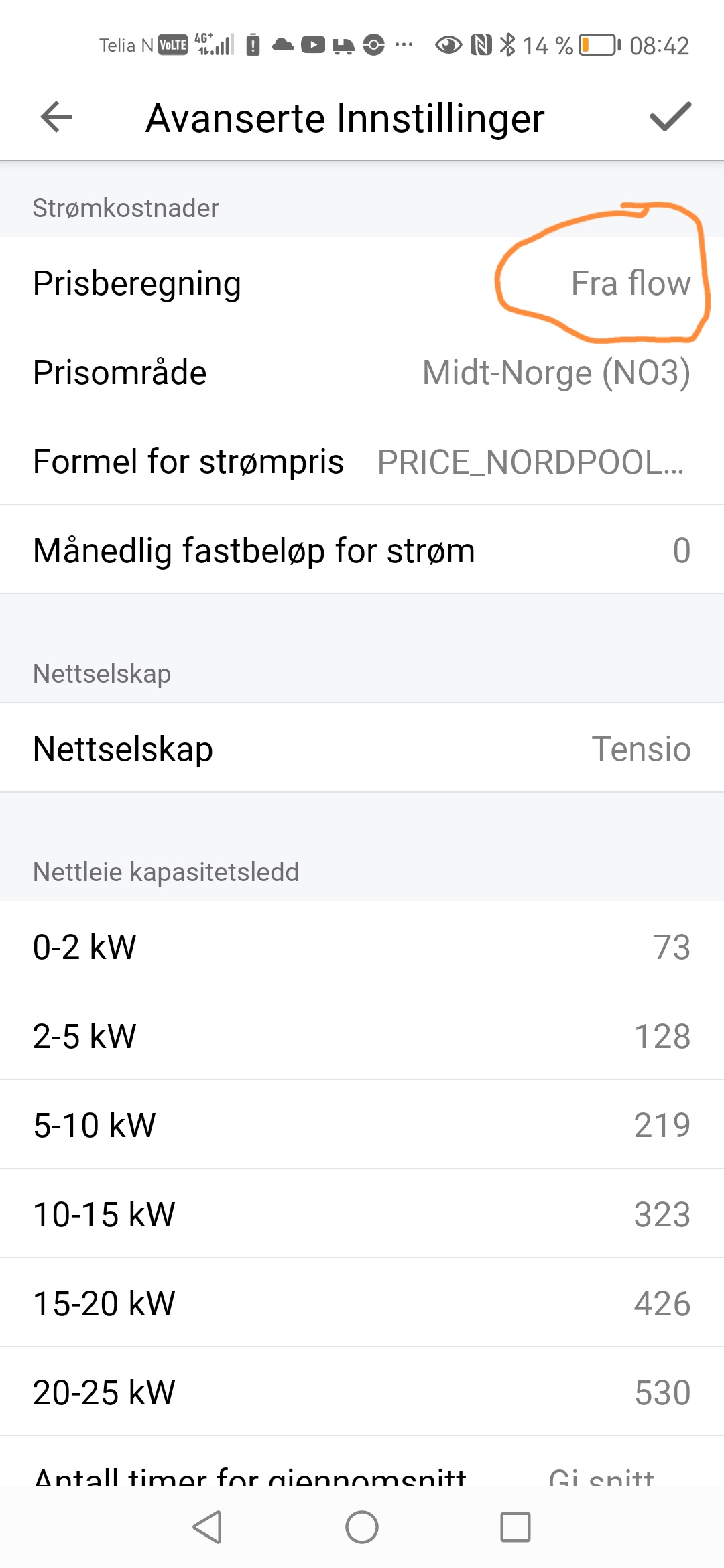

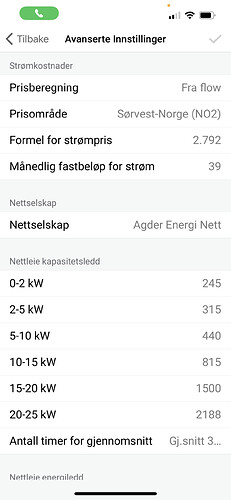

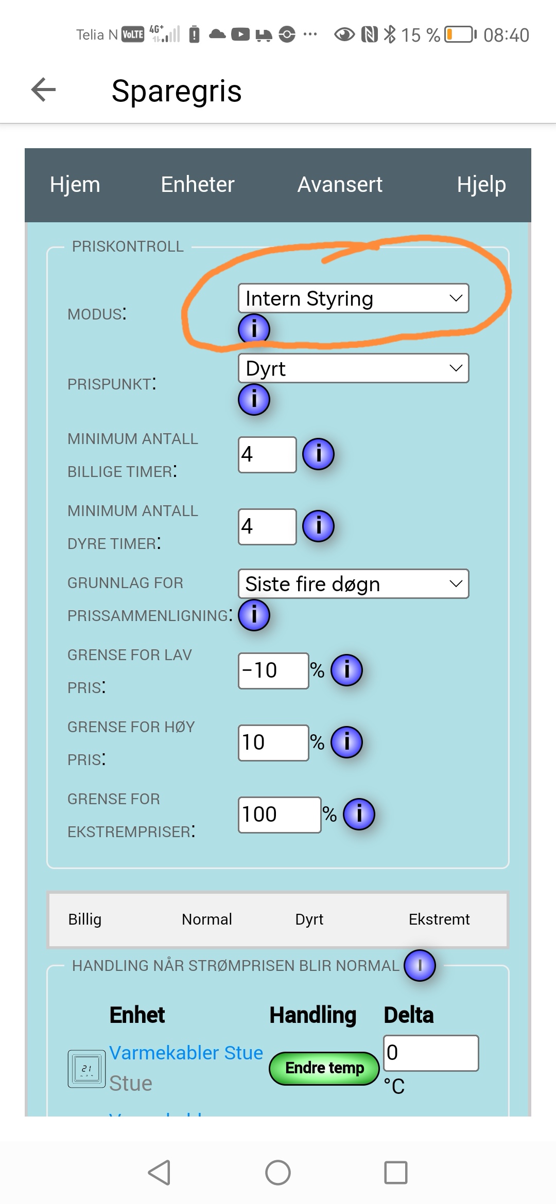

Hi
Here are my settings:
I’ve tried to toggle the settings and saved in Sparegris without any luck.
Right, but I suppose you get another error message if that is the case, because if you use that setting you will need to set up flows like this to make it work:
Ok, right… I took a brief look over the code and I agree, you have found a bug. I’ll fix it asap
