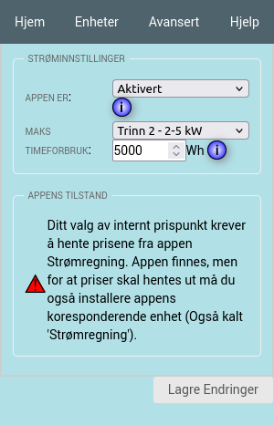

I have located the issue and added a warning in the app configuration page that will explain you what to do. You need version 0.11.5 to see the warning. I hope the new warning will guide you through the problem so it resolves.

@Torbjorn_Melbye , did you enter the setup and find the following instructions?
You need to install the test version of the app as this is not supported in the stable distribution yet.

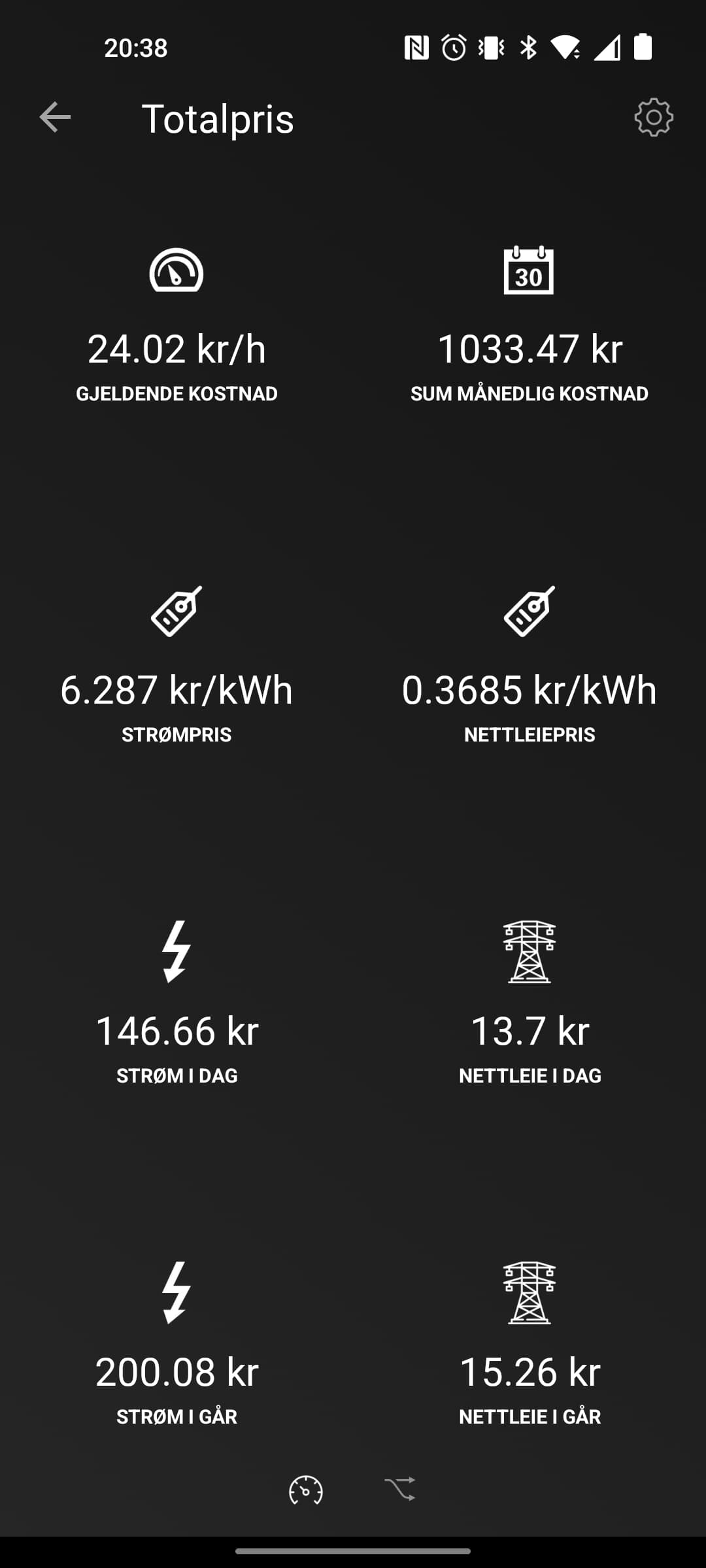

Well, the app has one master device, and slave devices so you donât have to set up prices for each device.
So I have one master device, that shows me the cost of my entire house (probably the one you fetch prices from), and several slave devices to show me the cost of individual devices in my house.
