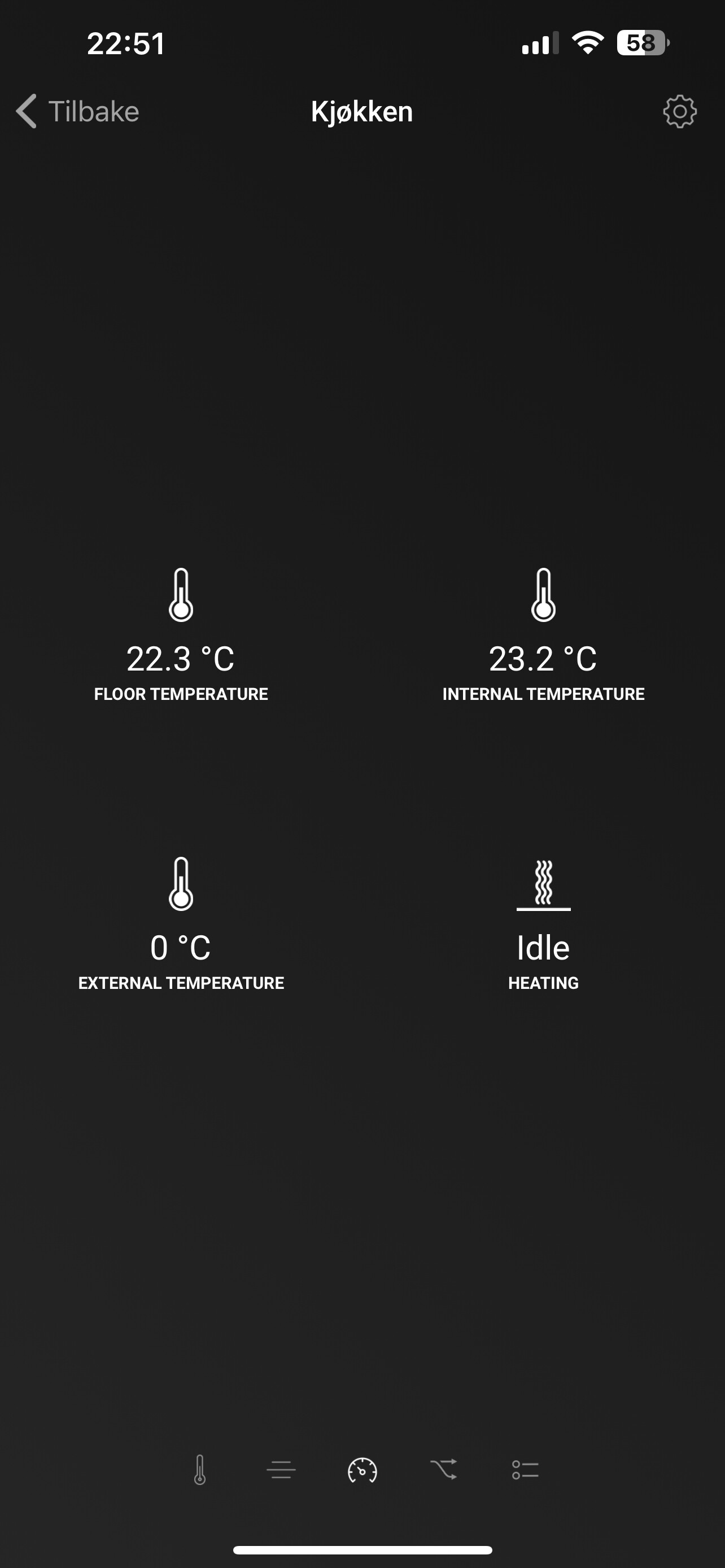

I have an issue when controlling Heatit ZTRM2fx. The piggy bank app sets the temperature on the thermostat to the same as the frost protection set point. No problem with the other ztrm3 devices. Is there any known fix for this?
This may happen in cases where the measure_temperature of the device in question is malfunctioning.
From an earlier device report I can see that this device has two temperature inputs, floor and external. In the previous report the measure_temperature was set to floor and had a good reading while “external” was 0. It may be in your case that measure_temperature is set to external. If so, the measure_temperature will always read 0. Can you please check your device settings in homey, maybe it is possible to select which of the two to use as measure_temperature?
If that does not solve it, can you please send a device report of the device in question (from the Help menu of Piggy) so I can take a look? Then I could be able to add a workaround.
Looks like the problem is the zterm not reporting any temperature to homey, i guess it should work if i figure that out.
Ok, it would be interesting to know what caused this.
In case you do not find out what caused this, it may be that you can add a workaround yourself by adding a Vthermo device to control the ZTRM2fx. Piggy is able to control VThermo devices and I believe you can use the VThermo device to manually select other external temperature sensors in case the temperature sensor for a device is broken.
I will try that. Attached screenshots of the termostat settings.
Does your thermostat actually have a floor sensor?
It may be that the electrician mis-connected the sensor and put it on the external sensor input instead of the “floor” sensor input.
I see from your screenshot above that you can select “Displayed temperature”. Can you change this to external? does it work then?
It could also be interesting to look at your device insights graphs at https://my.homey.app . I wonder if it stays in constant on state if there is no temperature reading? Does it power off at all? And… if there was a temperature reading earlier you would be able to see in the insights when the temperature readings stopped working.
Forgot to attach one image.
As you can see from that, the readings from the floor sensor is ok.
Yeah, but that was Z-TRM3, wasn’t it? Installed at a different time by a different electrician I assume, since it’s a different model?
The one named stue is a ztrm2fx. I had a factory reset on it and is working ok now.
The one named kjøkken is a heatit z-wave thermostat with firmware 1.92 installed. I tried factory reset on that as well, but no success.
