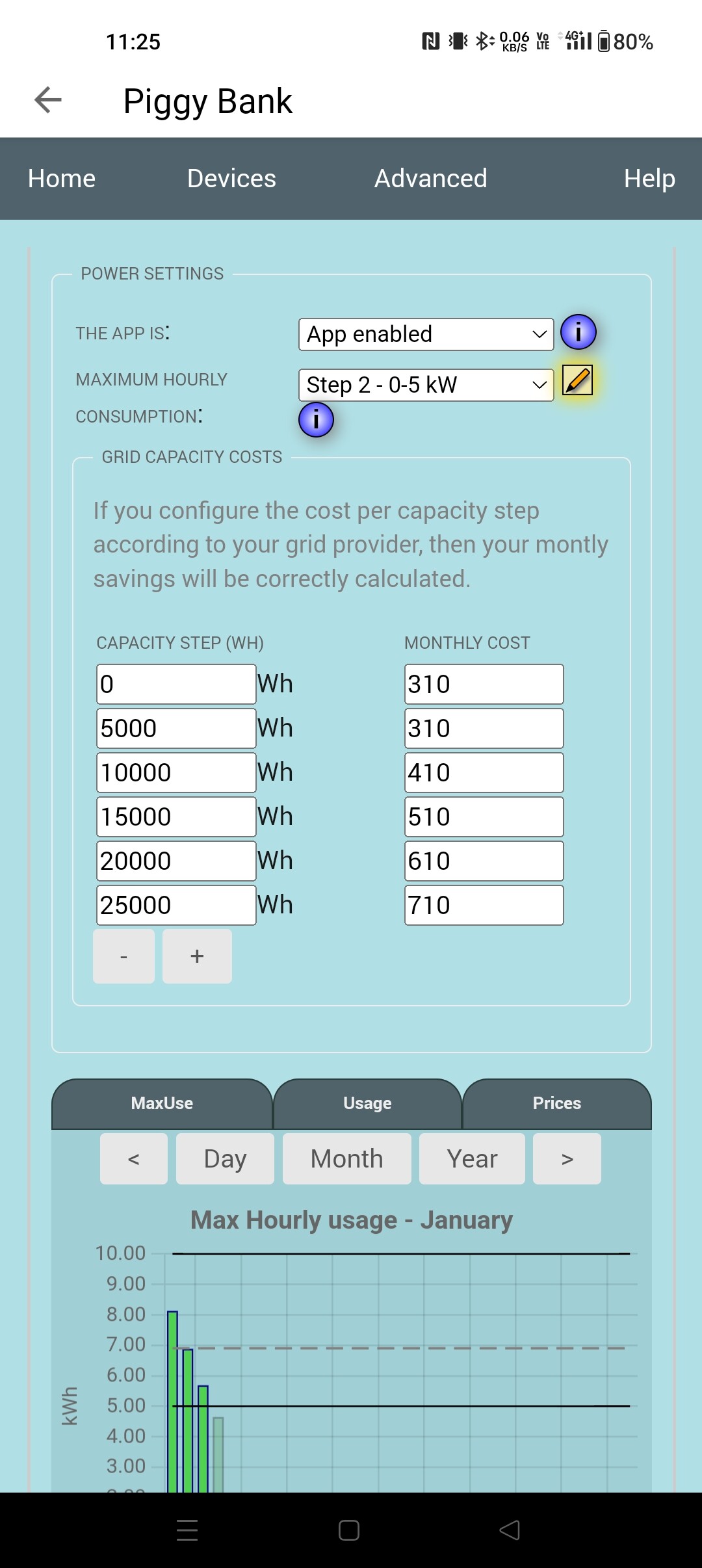

I put piggybank to 0-5kw tariff on the 31st of December, wanted to start the new year with lower power consumption. And I can see that it worked 1st of January, then it was high yesterday. And just checked, and it was up way over 5kw and still uskng the heat. Went into piggybank settings and see that it has set itself to 5-10kw tariff by itself.
I think I’ve noticed too late for this month. But I guess worth checking up on
This sound a bit odd.
  • Did you remember to save the settings after changing it to 0-5kWh? I know you said it worked 1st of January, but could this just have been a coincidence that you didn’t use enough power to be capped? Or can you see from the daily graph for January 1st in the daily settings that it was indeed capped?
  • The target tariff can also be set from a flow card named "Change max usage per hour" (or "Endre maks forbruk per time" in Norwegian. Are you certain you don’t have a flow that could accidentally have triggered this to have happened?
  • If neither of the two above, have you entered the settings after the 0-5kWh change and changed anything else, and then saved? (This should save the targeted tariff too although if it was not changed by you it should still have been at 0-5 kW - if not it is the only place I can think of that a bug is possible)
Other than that there are no ways for the app to change the value by itself other than a memory leak or corrupted memory.

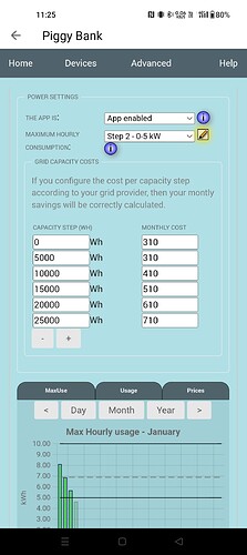

Can you also give me a screenshot of the values when you click the edit target-tariffs button? Like this?
If you have some odd values there I can see if it is those that caused it to jump.
Bug or not, the best thing I can do to prevent this from happening again is to add a confirm box when you try to save and the targeted tariff is changed to something higher. Then it asks you if you really want to do this change as that change would be irreversible.

I am sorry, I could not reproduce the issue with that table either… I see no other action than to add a warning dialogue as previously mentioned. I hope this will be sufficient for now.

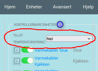

Hi, I’m using the app and it works great. One feature that would be great to have is that I would like the app to turn devices on and off as needed to control usage, but at the same time I would like to for some devices to be able to manually control the temperature in the room. Is this something that is possible today and I have not seen, or would this possible to implement?
This is possible, yes, although the way to do this isn’t very intuitive yet, so I will make some improvements for this later, but for now you can do this by creating the following flow card and run it once:
(e.g. The override flow card in English)
However, if you don’t want the app to control temperature on any units then you can disable the temperature control in the app altogether, which is a bit easier:
