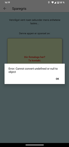

What to do? :ocean:
65fe2257-5eb2-4b27-90b7-756cc8482421
I have same problem, it came after a restart of the Homey Pro
Thanks, frodeheg. Seemed to work, but I noticed that Sparegris did not seem to adjust up the charing speed during night time. It should adjust both up and down depending on how much capacity you have before going over your treshold, correct?
And I also get the same error message Alf and Krisch2 now, so seems like something is down on the server side?
I confirm. I see the same now, but I cannot check what it is before I am home in an hour +
Are you all on the test release, or are some of you on the stable release?
0.19.26 for me
I am on stable @frodeheg.
No rush, take your time.
Same (I think i auto reboot once every month).
It seems to be related to Norges bank having changed their API today where I fetch currency exchange rates. I will have an update ready shortly.
