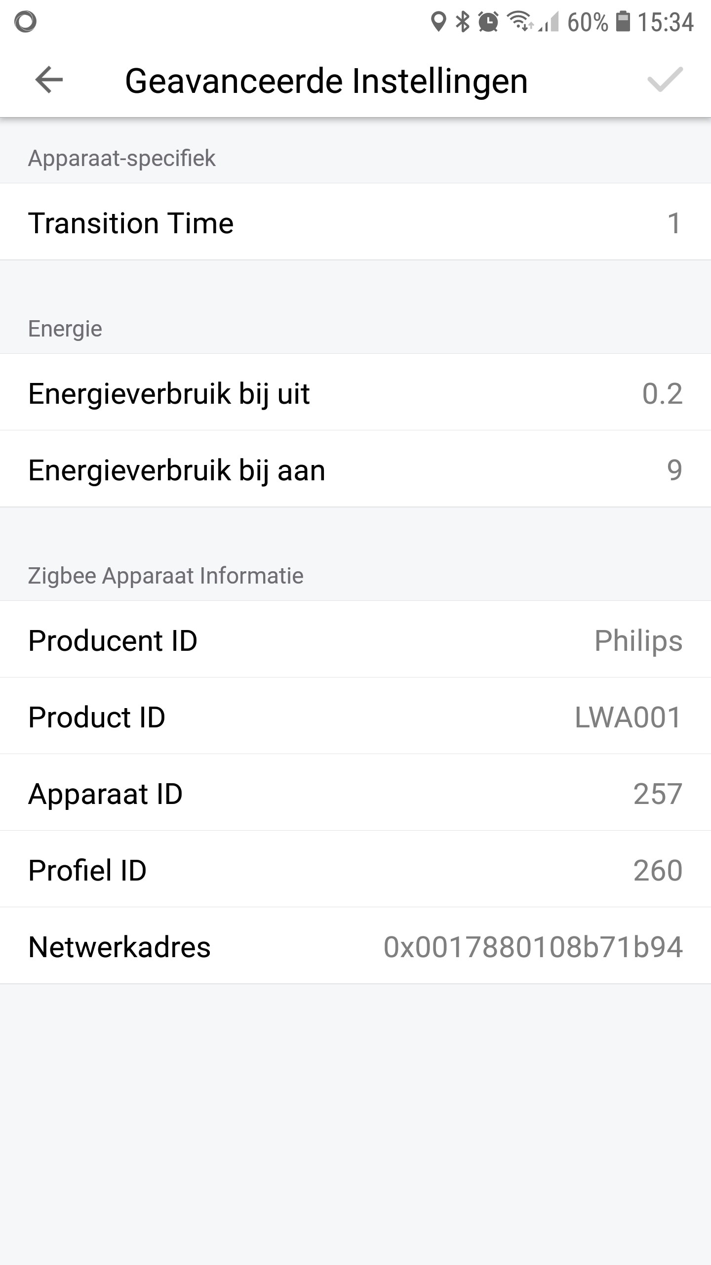

Hi all,
I’m trying to connect a White and Color E27 but I don’t see this in the supported list.
I do see the BT variant but not the “old” no BT version.
Is this correct or just missed as I see almost every Hue lamp in the list.
Thanks!
Hi @Y_D, what version of the app are you using and if you add the device as generic, what product ID does it report?
