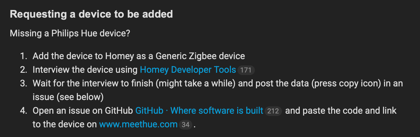

I am trying to add philips Gu10 white ambiance spot, homey only add it as generic device.
How can I fix this?
Please read my, and the previous posts for an explanation of why the spots are added as a generic device:
[APP][Pro] Philips Hue Zigbee (Without the bridge) - #1052 by DirkG
Please read the first post of the app developer:
Screenshot of the important part:

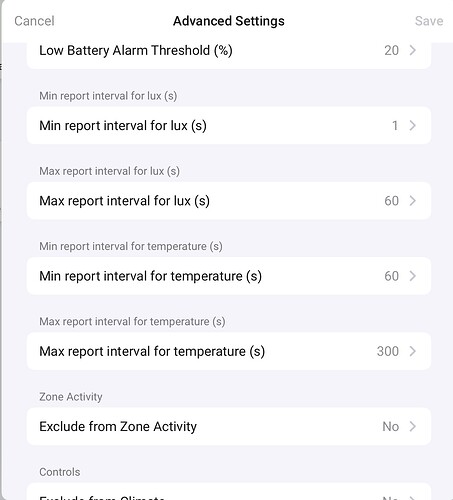

I finally took the risk of decoupling the SLM004 outdoor sensor from the bridge to try to get the Lux updated every 20 secs
Adding goes smooth … but is staying at 5 minute intervals unfortunately. I even tried a min interval off 1 minute with no luck
Any clue on how to solve ?
Edit : firmware 2.77.35
Anyone ?

These are my lux measurents and settings.
As you can see, the lux is reported every minute. When the I switch on the light, the lux is reported within seconds.
I use the app “Philips Hue, without the bridge” test version 2.1.0 and the SML004, firmware 2.53.6, is configured as occupancy sensor.

From what i see in your graph …it does report ever 5 mins right ?
Especially between 19.30 and 20.30 i count exactly 12 even steps down in your graph. So it does not report every minute .. but every 5 mins ?
Also if your MINIMUM is one second… then i would expect way more lux changes in one hour then just 12 even at 5 mins.
With the MAX 60 (s) i expect a forced measurement every 60 seconds.
So in that hour you should have had AT LEAST 60 changes. ( but during the day the lux changes almost every second and is hardly ever the same for a long period )
I also have changes when i trigger the motion sensor when i pick it up.
The problem is i have it on my roof … where there is not a lot off motion :rofl:.
So it needs a solid one minute pull even 30 secconds for example
I have exactly the same settings except the latest sml004 firmware and stable 2.1.
I also have a wire aqara sensor. That reports every second … it is cloud cover and grey now. So minor lux changes … big difference between 7.00 and 7.15 in my first screenshot
That is how th SML004 should have looked with you also if it respects the settings you have i think ( min 1 / max 60 )
See screenshots
Zillion reports ( every second the lux changes )
Aqara wired sensor
Just 3 reports between 7.00 and 7.15
despite min is 1 second… max is 60 seconds .
SML004
Your right. My misunderstanding arises when hovering with the mouse over the graph, you see a different value every minute. That is due to Insight making interpolations to get a nice graph. When I make an hourly graph it is clearly every 5 minutes.
It is just strange that the sensor does not follow its settings.

I wonder if i save wrong
  • I make the adjustments
  • Press the button untill it blinks orange / reddish
  • I save the settings
I hope the developer can have a look but i do not see much responses
