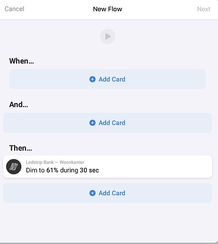

Use the “Duration” field.
Without even testing that solution, I can’t see how that would work unless I want the dim level to be set statically to 61% regardless of what I change to. I must be able to catch the dim level I change to, and use that as a variable for the “dim to during 1sec”. I have tried that, and it doesn’t work. It instantly sets the new dim level before entering the flow.
I gave you a solution for your question:
And now you refuse to implement this solution because you have another knowledge shortage and don’t know how to set a variable dim level?
How exactly do you set that variable? If you set a dim level in a variable, remember to use a number from 0 to 1,not 0 to 100. 0.1 would be 10%
Having the same issue here. Anyone know how to fix?
I didn’t refuse to implement it, it just doesn’t work. I appreciate you trying to help, but it seems I might have been unclear of the issue. Before when I used the Hue bridge, and changed dim level in Homey or via Homekit, it automatically dimmed smoothly. When I started to use “Hue without the bridge”, it doesn’t smoothly dim to the new level, but instantly jumps to it. The duration field works for flows, and I’ve used it successfully to configure my Hue remotes. In this case, however, when I dim through Homey or Homekit, it seems to send the command to the light before entering the flow, rendering the flow moot. I’m just speculating here, but I think that I must be able to intercept or ignore the command sent from the App to the light, and then have it control the light through the flow instead. Then your solution should work. As I said, that is speculation on my part and please correct me if I’m wrong.
Just show your flow😁, without it is all speculation.
By the way, how would a flow send a command before the flow is running?
We will find out as soon as you show a print screen of your flow.
