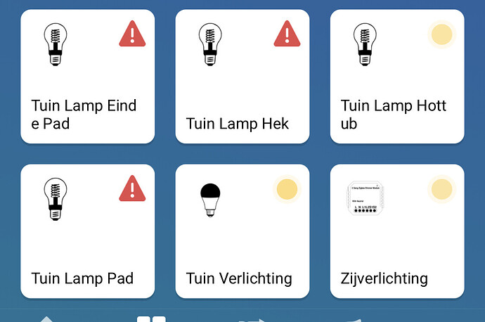

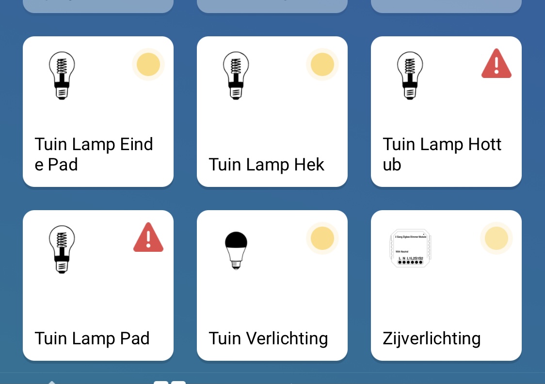

App broken again over the midnight update on v5 . Time to turn of auto update again.
Failed to initialize . Restart app doesn’t fix it
Different result every restart
Fix already in app store
It looks like some devices fail to init, I reverted the feature for Power On behavior and will work with ppl on CLI to make this compatible with all bulbs.
