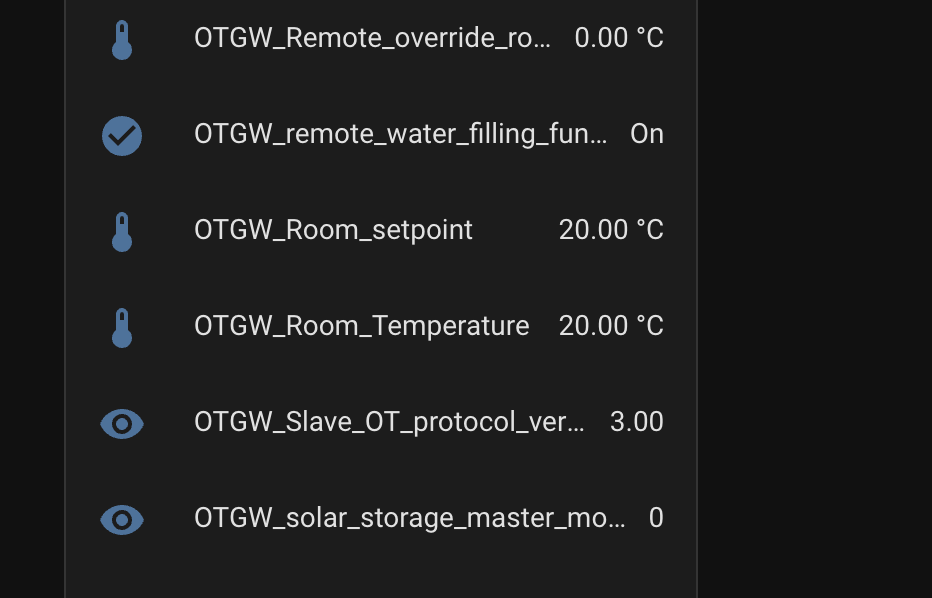

Only I don’t see the room temperature on homey.
A lot of thermostats don’t pass that value to the boiler.

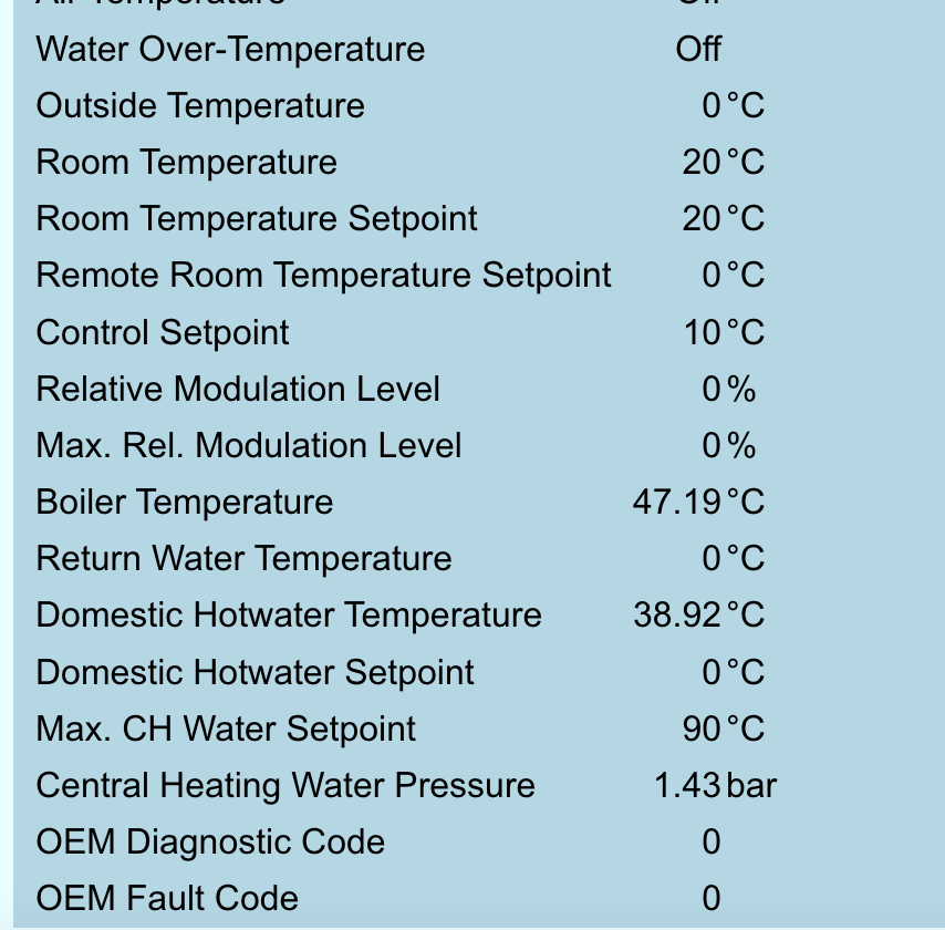

ok this 20 degrees shown there is not the same on the gateway and in mqtt
in MQTT the room temperature topic is called Tr, so that is what I use in the Homey app.
You could use MQTT explorer to see the live topic updates.
For expert help visit the Discord Channel: Discord
The developers of OTGW are there, and maybe they can help you to get the room temperature. But as @robertklep said, it depends if the thermostat provides this info in the first place.
thanks , nest has it on app and homey but indeed I don’t see it on mqtt
fixed, it is a topic and on homey I missed this message because I added the app later. restart gateway helped in pushing it again
