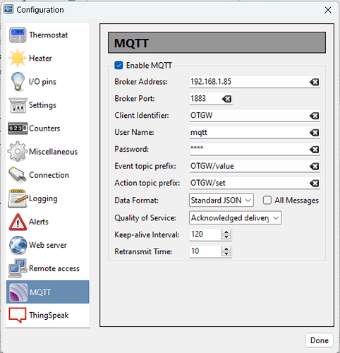

I installed the gateway today for the first time and have it connected to Homey using the Homey MQTT broker, used OTmonitor because it wouldn’t connect in the first 10 tries. Fiddling around and now it works / is connected to Homey through this app.
But now I have the same here for that offline thing, if I (re-)install the app OR I unplug the gateway and replug it after a few minutes, then it is online for a very short time and the gateway goes to offline again and stays offline. If I look at the settings in the OTmonitor, the Keep-alive Interval is 120 and the Retransmit time is 10. Playing with this doesn’t do anything.
So… Also here, how do I keep it online.
