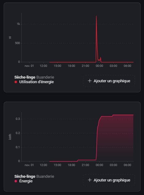

I have a A4z which is not showing power consumption, the A1z however does work well.
Any fix to show powerconsumption on the A4Z?
Hi Robert_A,
I will take a look on that but just keep in mind that Nous A4Z creates 2 devices on pairing and metering is only displayed on first device for both plugs (cumulated values for consumption).
I’m testing it right now but I need time because power consumption metering takes time to move (kWh). I plugged my washing machine and drying machine on both plugs, jus wait for my wife to play now !.. :laughing:
Regards,
SoPhos
Hi Robert_A,
Im made a try this night and everything seems working fine with Power consumption on Nous A4Z.
On screenshot below, first insight is the Power (immediate use, in W) and second one is the power consumption (in kWh).
Regards,
SoPhos
