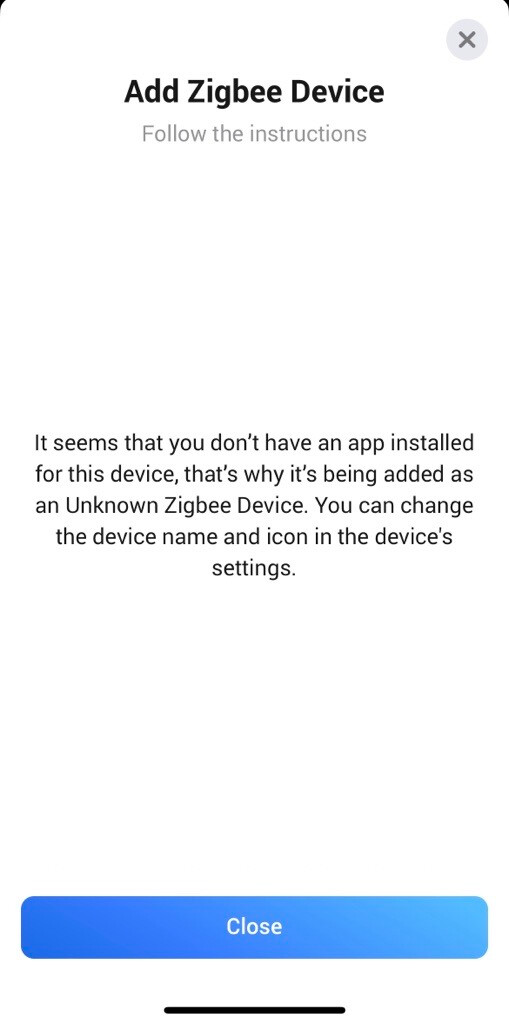

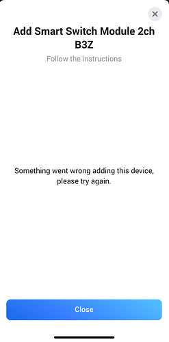

Hi @SergeP,
First of all, thanks for this app!
I bought a Smart Switch Module 2ch B3Z which I can only add to Homey as a generic zigbee device (shows up as Unknown Zigbee Device) not using the NOUS app because a “Something went wrong” message comes up everytime…
The device details are:
Manufacturer ID: _TZ3000_aaifmpuq
Product ID: TS0002
Thanks in advance!
Hi MrMartins,
Manufacturer ID “_TZ3000_aaifmpuq” and Product ID “TS0002” are actually the one recognized by Homey Nous App, so this should work as it.
Can you try again first resetting your device by pressing the button behind your device for 10 seconds until the led flashes - and do this twice ?
Then control there are no more devices paired with Homey (the default driver one).
Finlay, try again to include your B3Z in Homey by taking it very close to your Homey box (to be sure).
And if it still doesn’t work, can you send me an App Debug report ?
Thank you,
SoPhos

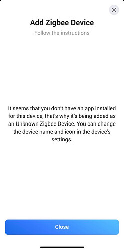

Hi @SergeP,
I did what I usually do when I add a device to Homey.
However, I repeated all the process from scratch after those steps you mentioned before and the result was the same. I don’t know/understand what I’m possibly doing wrong…
Here’s another report of my last attempt
2e7a8d9f-75a8-4400-b8a4-69660e66a01c
Can you see if there’s anything different in the log?
Thanks!
