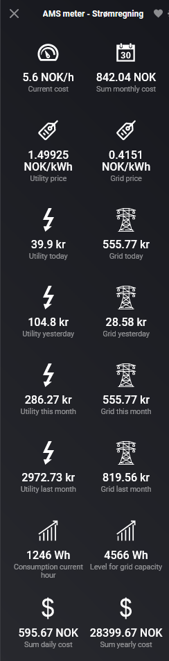

@balmli So it’s a new day, but there was no change (running the latest test version), sum daily cost is still all wrong.
Can you test v. 1.4.5 ?
Can you send a screen dump of your values ?
I did post a screendump a few posts up, but I can do it again:
And here are the settings:

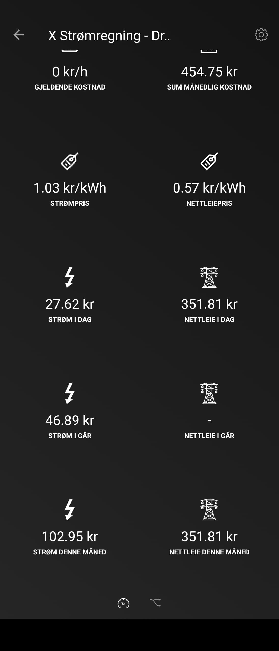

One more thing: I can see that the value for “Grid yesterday” hasn’t updated, when hovering over the value, I can see it was last updated 3 days ago. This probably has something to do with it, I guess.
I installed the app on 1st of July and have same issues. Now also testing ver 1.4.5, but no difference.
@balmli A new day has just begun, and this time my daily cost did reset to zero as it should, which is good. However, “Grid yesterday” (and “Grid this month”) still shows a unreasonably high value (667 NOK) for only being three days into the month (total energy spent so far is 133 kWh).
